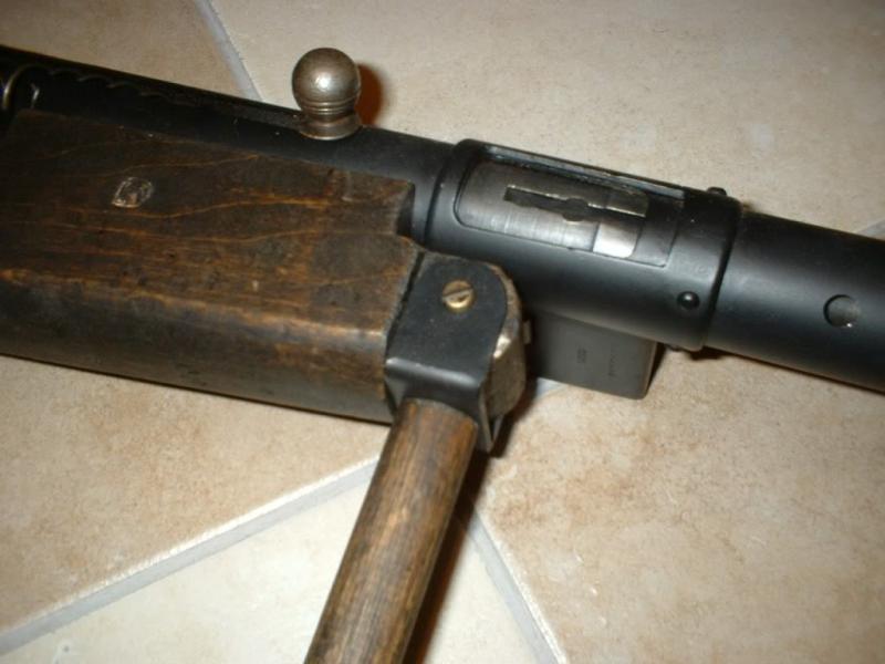

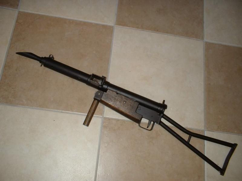

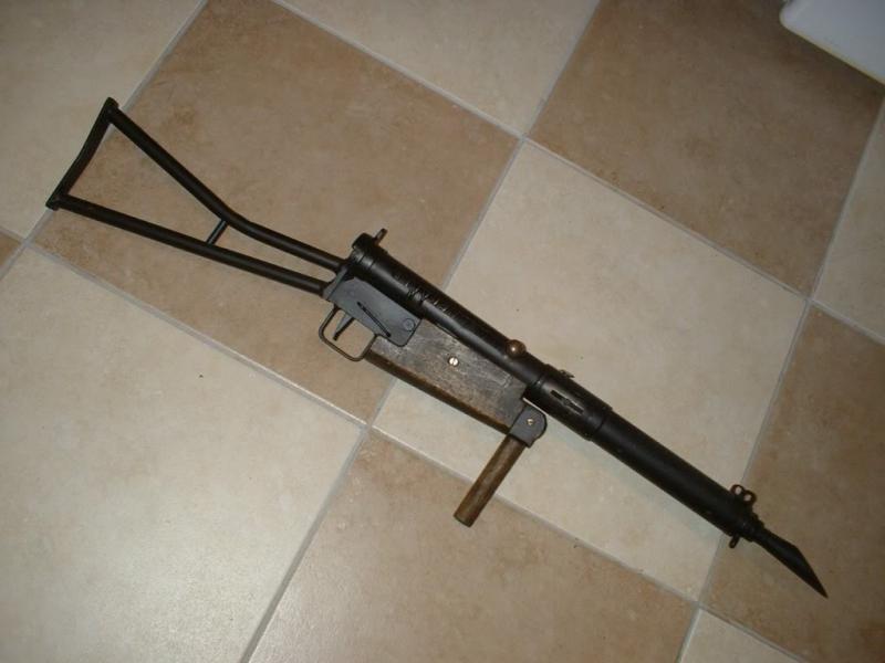

    Wow, that Mk1 is nice, I'd love one. I was offerd this one a while back but I thought it was a copy (I still think it is).
    (I tried to load these to the site but nothing happend when I clicked on upload, am I doing somthing wrong?)

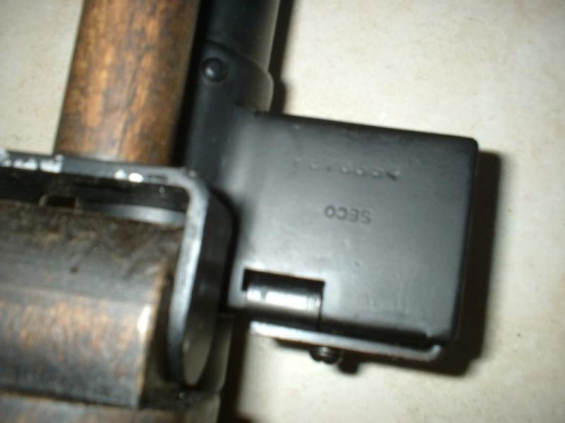

    What is strange about those photos is that the Mk1 mag housing has SECo underneath which is the logo for Sterling Engineering Co............ found on Sten and Lanchester magazines and not on Singer Mk1 guns. Or am I missing something?
    Likewise, the wooden trigger mechanism cover isn't shaped to retain the trigger axis pin and it has a Mk2, much later, magazine catch. And unless I am mistaken, didn't the production Mk1's have the barrel retaining screws going horizontally (the pre productions had them vertically - or vice verca)
    I couldn't point out what I thought was wrong, somthing just didn't quite fit.
    Quote Originally Posted by Peter Laidler View Post
    I have no idea, I'll read your book!(Or look at the photos as we know armourers can't read)

    Oh, and during my research of that Sten, I found it was deac'd by WWA, and theres a rumour they made some Mk1s from parts sourced from the Ishapore plant. This mag housing just happens to have RFI stamped into it.

    The trigger pin does seem to be hanging out in the open. Wonder what is retaining it?

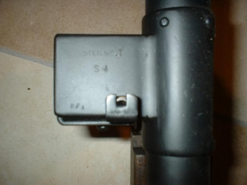

    Any photo of the front of the magazine housing? If it is a reworked Mk. II, there should be some patched holes. The length of the collar in front of the magazine housing seems more Mk. II length, and the rivets don't look correct.
    The top and bottom of the buttplate look to be flat, rather than radiused.

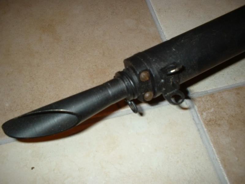

    The flashider shows lathe turning marks inside and out. Is this correct?
    The front sight is attached with tack welds, does not have the flanges formed when the windows were punched out of the guards.
    While there are numerous variations seen in Mk. II Stens, because so many contractors were making parts and sub-assemblies, the Mk. I guns were made by Singer, and I would expect greater uniformity.
    I suspect that the gun is a representaive specimen assembled from odds and ends of parts.

    Unfortunatly these are the only photos of the gun as I decided against buying it. I hadn't noticed the incorrect front sight protectors, thats a big give away!
