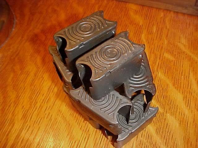

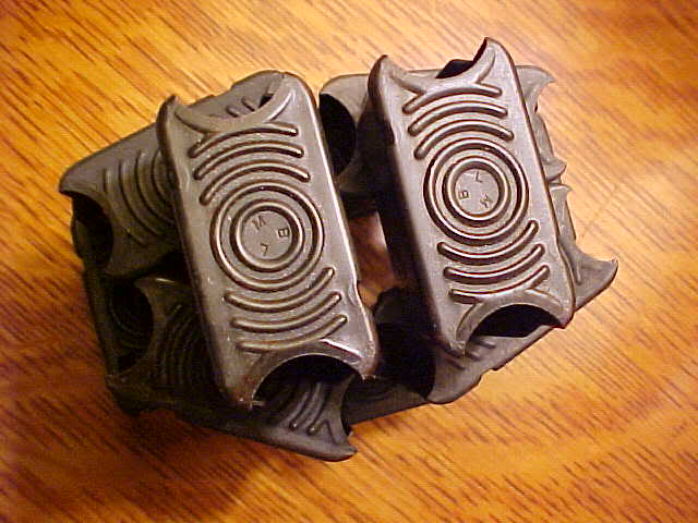

    I don't shoot my Garandicon near enought but I'm always on the lookout for reasonably priced 30-06 and the enbloc clips.
    Visiting my dad at the farm two states over, I will generally visit some antique stores along the way.
    Just last week while I was visiting him, I found a small stash of eleven American made enbloc's (Borg Warner's, Barry L. Miller Eng., Stamp Wade Electric Products) at an antique store for $7. Not a bad price for the American made stuff. Here's some pics:
    Kim
