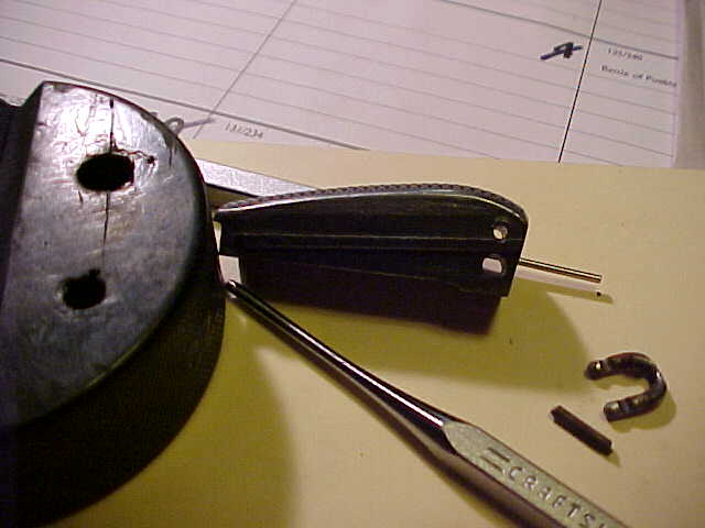

    You cold try that but as you mentioned, why take the risk. Instead, remove the grips and set frame on a solid surface. A nice piece of pine 2x4 will work. Tap out the MSH housing pin and slide the MSH out. I used 3/32 punch on the one in the picture. It came from an old Sistema and it was tough to remove. You must hold the MSH firmly, while holding the punch and hitting with a hammer. It took a number of blow to finally get this one to start moving. I have a stubby punch for starting, it's less likely to bend or break. Once you get the cross pin to move you can continue to tap it out with a longer punch. Use a small screw drive to pry out the lanyard loop. Usually they aren't too hard to remove once the cross pin is out.

    Got the crosspin out, but try as I might, the loop would not come out or budge. It's wedged in really tight. Wound up putting the MSH in a vise between two blocks of pine and using a large brass punch, got most of the bend out.

    Usually you can dive something wedge-like through the loop and it will pull it out of the MSH.

    IMHO, and a little experience, it would have been much easier to do what you suggested in the first place and a lot less likely to damage the MSH. That loop is tough and I usually use just a brass block and a hammer to straighten them without trying to remove them. (If the loop is bent forward, I never even take the MSH out of the gun, just rest it on the bench pad and whack the loop.)

    It was a reblued all original Rem Rand that someone tried to pretty up. I removed the MS housing and soaked the cross pin and the lanyard stub ends with Kroil for a couple days. The cross pin drifted out easily, but had some rust on it. I was able to coax the stub remnants out with a small drift, engaging the concave relief for the cross pin through the cross pin tunnel.When enough of the stub was exposed, I was able the remove it with vise grips. It took a while, but they came out with no damage to the MS housing.
    I replaced it with an original loop I got from Bill Ricca. Used the original cross pin.
