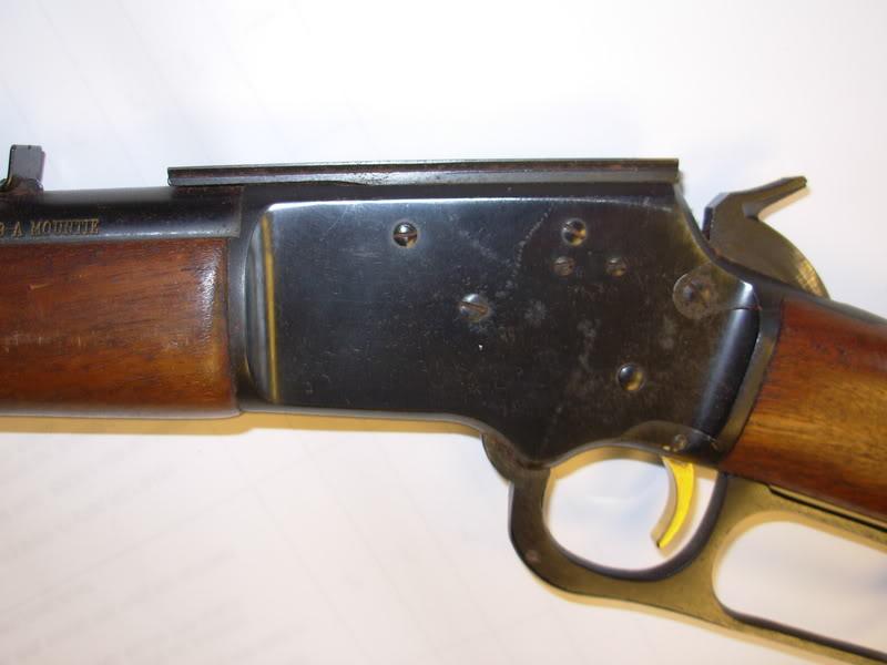

    i used the warnes as well , but i was mounting an extra heavy scope - just because i had it ? not the best photo -
    to the original marlin steel rail -
