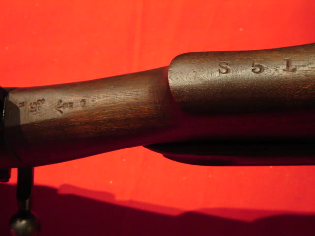

    I’ve been looking over the photos the seller has provided and they just didn’t look right. I’m sure it is a legitimate No4T but I suspect the forearm is a replacement. Also looking at the S51 on the butt stock I’ve never seen a such a large space between all three letters/digits. I’ve seen a space between the S and 51 but never between all three. Now I hasten to add that I’ve only handled 7 or so No4(T)’s (4 of which I owned) so I’m just wondering how common this is? Any thoughts? It’s also missing it’s front sight protector and magazine. The asking price is…..$6000.00 !! The sellers text reads as:

    Well if anyone would know it's you Lance. How common is it to see the serial numbers on the forearm with the circle from the end of the punch around them? They also look to be upside down to what I usually see as well. Any comment on how common it is to see the widely spaced S51 marking?*As for price it's atleast $1000.00 to $1500.00 above the going rate here in Canadaicon at the moment.

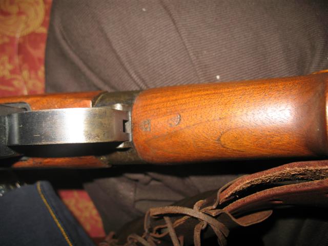

    Before I'd spend $6,000, I'd like to see a few more pics of this area where the serial number of the scope is stamped. Obviously the scope matches it's canvas scope bag and that in-turn matches the rifle serial number, which is a good thing, but the wood stamping in the pic below seems to show a very FLAT area.
    It might just be the camera lighting, but at that price, I'd want to make sure it wasn't sanded and stamped over a previous number.
    Just my opinion and remember, I'm a K98kicon collector ...
    It does look clean other than that, but as mentioned before, there's a bunch of experts on here who would know far better than me.

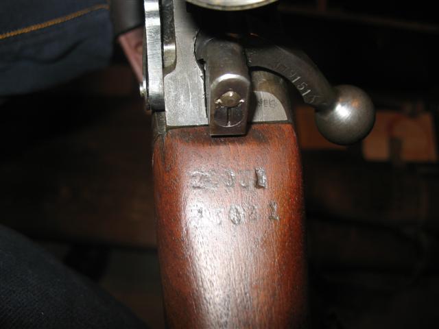

    Badger,
    It sure does look sanded to me as well.

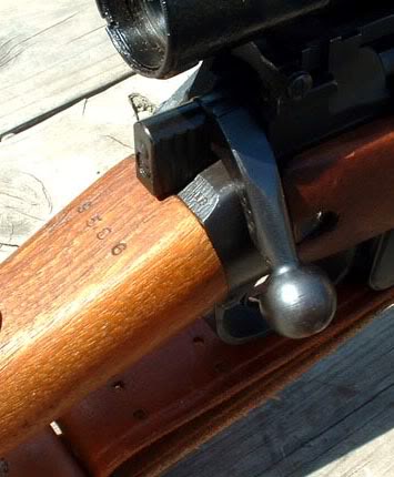

    I'm not the expert that some others here are, but here's what mine looks like in the same area:
    The wrist area also looks like it's been sanded?
    Here's mine:
    Here's his:
    Some stuff there just doesn't look quite....right.
    Interestingly, my rifle is S/N X33021, his is X33257, so the S/N range matches, but his scope number is 24515, mine is 23631.
    He has an earlier production rifle, with a later production scope?
    I'm wondering if we have a #4(T) action that's dressed in someone else's wood.
    NS

    There is just something about the wrist numbers. But I have seen the wrist flat filed and struck on a few rifles so it might be OK. I'm just used to more uniform striking on a more rounded surface. Front sight cover can be missing for any number of reasons.
