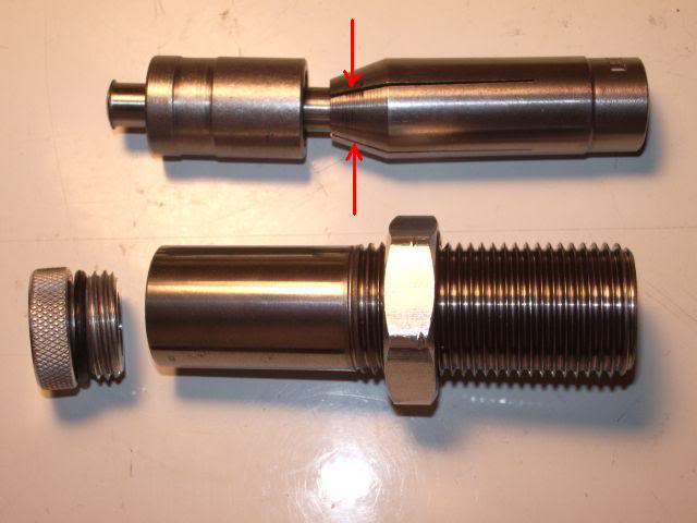

    The Lee Collet Die is a little rough after manufacture, specifically the fingers on the collet, they can have burs and rough edges that can cause you trouble with the die and your cases. Lightly sand-polish with fine sand paper to remove any rough edges at these slots marked in red below.

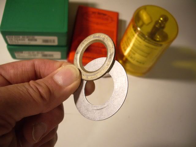

    For "partial" full length resizing go to your local hardware store and buy washers that fit your dies, with the proper thickness washer your dies will be backed off the shell holder the proper amount without the need to readjust the dies after normal "factory adjustment".
    Always use a lubed case when setting up your dies to "center the die in the shell holder and align-center the die in the reloading press threads, and then tighten the die lock ring. This prevents inducing any misalignment in the die and your reloaded cases.

    Edward ... Yes, I did read the instructions beforehand , but for all the reading , you only really learn when you try to do it . I know FLR'ing will reduce case life and I only did it because of the problem . Good pictures , thanks . I will try smoothing the slot edges . Your collet die cap looks to be made of steel . Can you confirm this ?

    I'm now thinking (from the above info) it may be caused by rough collet slots combined with an alluminium cap . Or am I still missing something ?

    I prefer using a RCBS neck sizing die to using the Lee collet die, the collet die leaves longitudinal marks on the necks. It also has variable crimping results with different type-make cases and increased bullet run out. (wobble)
    The cap on my collet die is aluminium and the die should be lubricated with a dry lube like powdered graphite or a dry spray lube for smoother operation. The mandrel floats and moves during the crimping-sizing operation and this can and does cause more bullet run out or wobble.
    I'm reloading Greek HXP, Remington, Winchester and Prvi Partizan cases and I did not like variable differences in neck sizing with the collet and case brands. The old fashion basic Lee Loader and a plastic hammer has more uniform neck sizing, less bullet run out and smoother necks along with the results of standard RCBS dies.
    If you watch the instruction video your "arm" and your downward force controls internal neck size and thus neck tension. My elbow doesn't have an adjustment knob on it to set at 25 pounds and this can cause too many variable sizing-crimping results.
    My Lee Collet die only came out for the photo session in this posting and was put back into the rear of the storage cabinet to gather more dust. Sizing accuracy and uniformity are more important to me than "speed" and I reload for accuracy.
