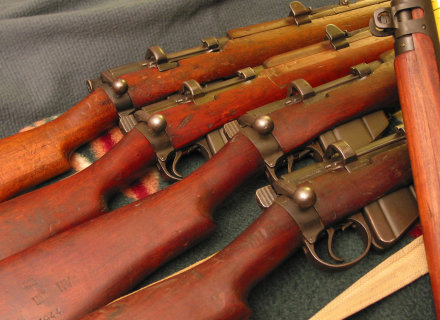

    I'll go thirds on the bore condition thing. My '45 Lithgowicon has fairly pronounced pitting in the last eight inches of the bore---but the rifle is still wearing the unique Aussie chrome green paint under the wood and that's something that would be lost in a barrel replacement.
    Also, mine had staked screws identical to those on limpetmine's rifle, but the staking was relieved by a previous owner---unfortunately.
    -----krinko
    Second from the top in this photo.
