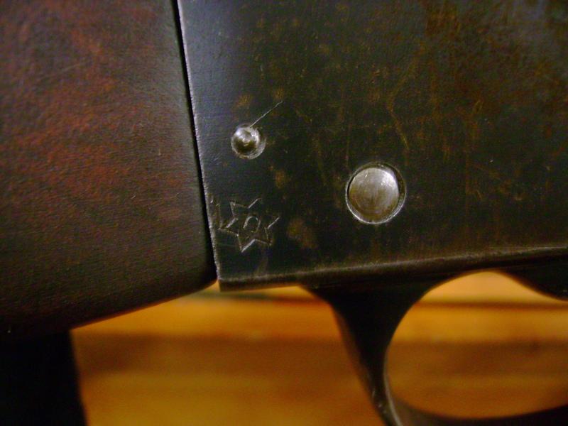

    Strange proof marks on Greener Mk.III
    I found most of these marks here: http://www.phoenixinvestmentarms.com...Proofmarks.pdf
    But, I can't seem to find the 6-pointed star marks?

    Israeli Defence Force inspection marks
    OK lads, I 've just been away for a couple of weeks, so I may have lost the plot with regard to rifle markings. However, as no-one else has yet posted an answer, this one should be at least good for a laugh until the real answer turns up...
    The marking on the left looks most like a Hebrew "tsadi" or TS sound. Take a look at an Israeli Mauser, if you have one to hand.
    The marking in the right looks most like a Hebrew "nun "or N sound.
    Such letters in 6-pointed star markings were used by the IDF as inspection marks. My interpretation is therefore:
    Ex-British police/prison service gun acquired and remarked by the Israelis.
    Patrick

    Thanks, Patrick. I never did post the 3rd such mark.
    A gent from another board stated (as you have) that the same marks show up on Israeli K98icon's.
