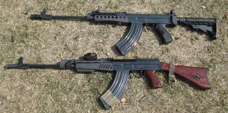

    Here's a couple of pics of the new NEA railed barrel clamp. It's on the same plane as the other NEA rails and allows you to mount a small optic without needing to remove it for cleaning. I will have to either move the mount or the optic forward a bit to allow the piston to be removed for cleaning.
    The M4-type stock adaptor virtually elimates muzzle rise with it's inline design. Neither I or my shooting buddy could notice any rise when we took turns shooting it with the other observing.
    Overall view:
    Detail view:
    Both of my VZs (prior to mounting the optic on the clamp rail):
