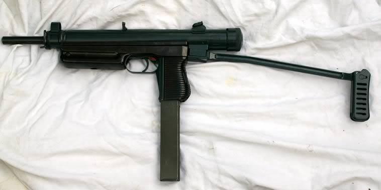

    What weapon are 7.62x25 strippers designed to feed?
    Got a crate of Czechicon surplus, it came on 8 rd stripper clips, 5 to a box. I'm guessing the clips charge some sort of SMG. Which one(s)? I have to peel the clips to load my TT33.

    This:
    From BSAPIMAGES on photobucket
    I've called them CZ26s but there are some alternate designations.
    Only had access to one for a few months several years ago, but it was quite efficient.
    There's a little recess on the right side of the front hand hold where you can place the charger/clip to help load the magazine.

    If it's on clips, it was intended for the submachine gun. The CZ52 pistol is about the only handgun in which this ammo is safe to shoot. MUY HOT!
