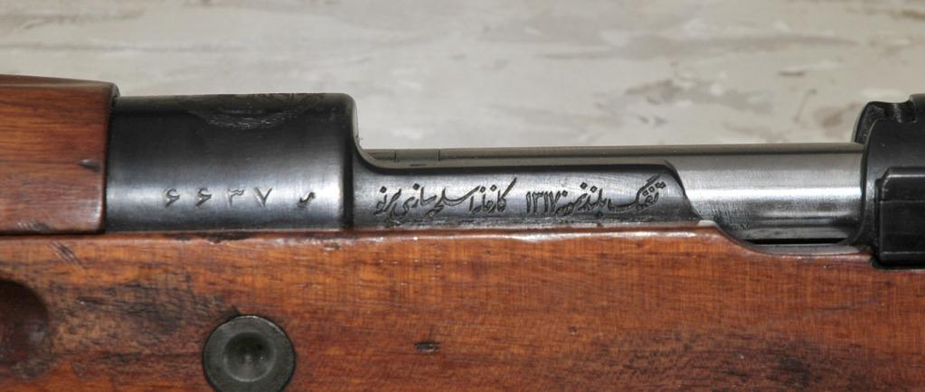

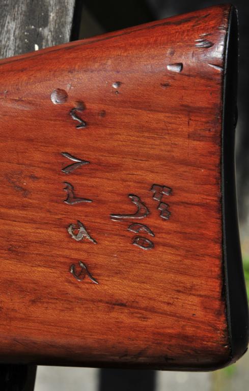

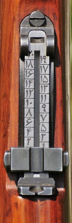

    I´m sure that i´m not the first to ask this, but can anyone tell me the meaning of the Parsi signs at the rearsight of the Persian Mauser is? I added some pics of the rifle and there´s a writing at the buttstock which would be interesting to decipher.

    The rear sight markings go from 1 (100m) to 20 (2000m) and as you know are the range settings. The other markings I do not know for sure. The model number and serial number, probably.

    On the rear sight looks like you have the numbers 1 thru 20. Number one is at the lower right and, going up the sight ladder, two is the next number immediately above and to the left. The numbers then proceed going up from there (three directly above one and four directly above two, etc. Looks like it would correspond to 100 thru 2000 meter marks in a standard Germanicon sight.
    On the stock you seem to have S/N 6637 and a symbol that is either y or i and them some writing below the S/N.
    The receiver seems to be S/N 6637 and that y or i again, and to the left some Farsi characters.

    On the receiver, from right to left!
    Tofang-e-boland namunah 1317 (number is read left to right)
    = Rifle, long Model 1317
    Karkhaneh eslihah-e-sazi Brno
    = Brno Arms Factory

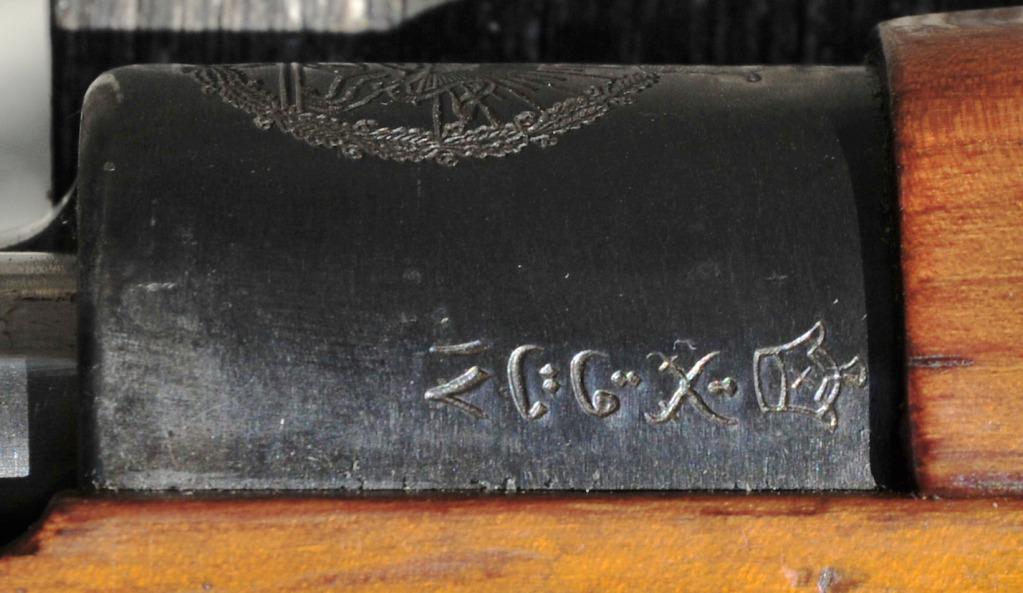

    On barrel ring, left
    6637 * (not sure what the * is)
    On barrel ring, right
    17 ??? + crossed swords, looks like an acceptance stamp/date
    On butt also 6637 *
    i.e. matching stock
    below is
    Piyadeh
    = infantry
    And, of course, as already pointed out, standard range numbering on the backsight leaf.
    Hints for numbers:
    1 is obvious
    2 and 3 can be recognized, if you imagine them lying on their sides.
    9 is obvious.
    . is 0, so 1. is 10
    And the rest you can work out!

    Ullrich, your next-to-last picture (the butt) shows the number and "Piyadeh" stamped over the finish - look at the way the second "6" has cut in. This shows that the number was applied after the finish - that looks ike a very fine 100% original rifle.
