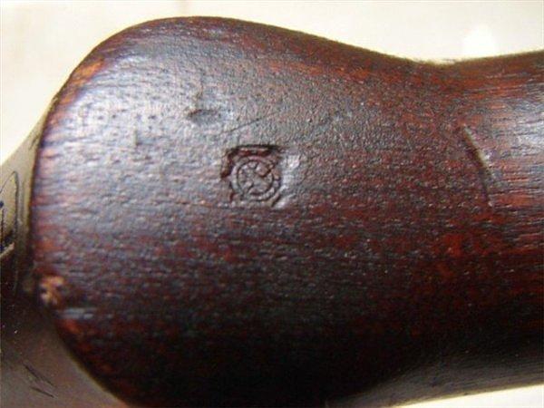

    Since 1/2 my google results while researching about M1icon Garands lead me to your fantastic forum, I thought I'd try my hand at a question I can't figure out.

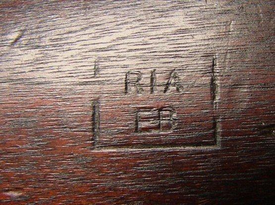

    I have an opportunity to buy a Garand offered as being correct. The cartouches confuse me as it has a circle P without serifs, a small ordnance wheel and an RIA EB all on the stock.
    I thought the circled P without serifs was used by Winchester or HRA, or is it somtimes used in an ordanance rebuild?
    I'm confused about the small ordnance wheel with the sans serif P. Help me understand how and when they were used together.
    Lastly, shouldn't a 'correct' rifle have a stock with one of SA's cartouches and not an RIA EB cartouche?
    Here's some pics...
    Thanks for the help!

    The original Winchester circled P stamp has the serifs. The second P proof stamp can be either a non serif P or a serif P stamp depending on the time/place of rebuild. The small crossed cannon stamp started with the later SA EMcF stocks, SA GAW, SA NFR and original SA SHM stocks - it is located on the top of the pistol grip and is not a rebuild stamp.
    Photos show an early Winchester stock with the original P proof with serif and a second firing proof with the non serif P. Second photo shows a Winchester stock with both original and second proofs with serifs. Your RIA EB is a post WW2 rebuild stamp

    The tiny Ordnance crossed cannons mark on the bottom flat of the stock grip is the Springfield Armory Stock Shop acceptance mark. As RCS stated, it was first used during WW2 on EMcF stocks and continued throughout the end of the War.

    Thanks for the replies, but I'm confused. What would small cross cannons be doing on a Winchester stock? And does anyone else see a second serif P?

    Simple, it is not a Winchester stock. It is a WWII SA stock that has had the cartouches and proof P sanded off and rebuild stamps applied in thier place. The bottom of the grip did not require much sanding so the small crossed cannons are still there.
