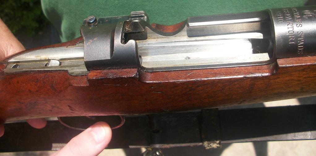

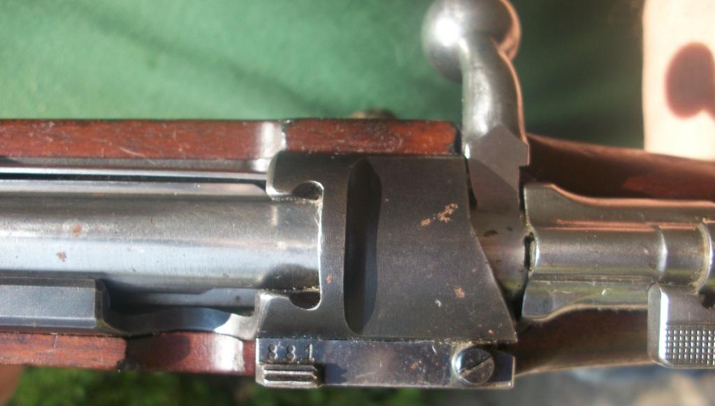

    Looking for more information about this rifle. Bolt is mismatched but over all the rifle is in beautiful condition for it's age. I'm curious as to what the flash hider and hooded front sight are for. I figured it may have been a competition rifle because of them, not to mention the condition.
    Help and answers would be greatly appreciated.

    The rifle was threaded at the muzzle to attach a blank firing device. Guys don't like the look of the threads and have been putting on after-market flash hiders to get a better look. No Army Issue at all, made in the USAicon. Sight hood appears Army Issue.

    As Calif-Steve pointed out, the threading was for BFA....
    Swedishicon BFA (Blank Firing Attachment) designed to be used with WOODEN bullets
    (Click PIC to Enlarge)
    The following pics show ..........
    M96 or M38 threaded barrel rifle ............... plastic or metal thread protector ..................... BFA mounted for use
    (Click PIC to Enlarge)(Click PIC to Enlarge)
    Swedish 6.5 x 55mm m/14 wooden-bullet blanks for use with threaded muzzle BFA (blank firing attachment) and Swedish 6.5 x 55mm m/12 Kammarpatron (gallery cartridges) for indoor training use at 15 meters. Harmless beyond 200 meters.

    I am unsure about the bent bolt; normally they are straight. Since the bolt doesn't match, perhaps it's out of an M38 carbine? Or maybe one someone had turned down... A very nice rifle overall; I sort of miss mine and I'll have to get another one some day!

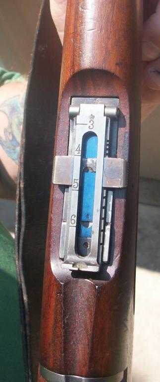

    1. The rifle is a mixmaster, with parts from at least 4 different rifles.
    2. The sight hood is a standard add-on piece of equipment - it does not indicate a special rifle.
    3. The bolt handle looks like it was turned down by a gunsmith. Not factory-made.
    4. The stock disk is probably not original - note that the dent in the wood by the upper number 5 has not marked the disk. The wood has a lot of dents and scratches - the disk has none. Very odd.
    5. But none of the above points means that it is a bad shooter. For that, it wold be more important to check that the barrel is not binding anywhere in the channel. Binding will show itself as a POI that relentlessly wanders in one direction as the rifle heats up.
    6. And don't waste time and money checking the headspace with a SAAMI gauge. It will probably "fail". Swedishicon Mausers were NOT made to modern specifications. Whatever the accuracy, reload with neck-sized cases fired in the same rifle, and it will be better!
    Patrick
