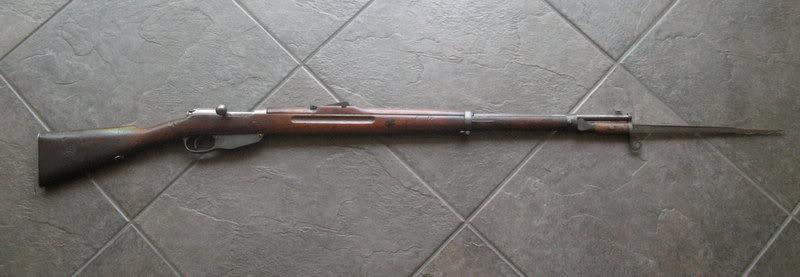

    Dutch Steyr Mannlicher M95 rifle with early bayonet.
    This post is about reloading for my Dutch Steyr Mannlicher M95 rifle again.

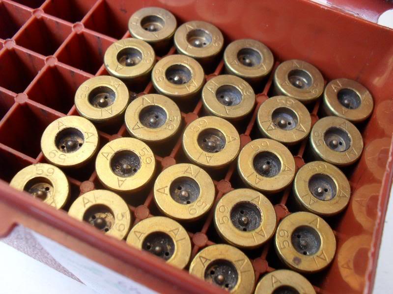

    This time however I decided to try the Dutch .303 British cases.
    These were manufactured by AI (Artillerie Inrichtingen) in 1959.
    AI was the Dutch State Weapons and Ammunition Factory.
    The quality of the brass is great.

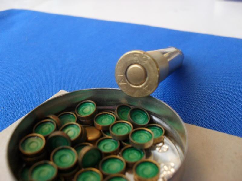

    Problem is that these are Berdan cases and don’t use the 5.5mm (0.220”) Berdan primer, but the larger 6.34mm (0.250”)Berdan primer.
    Uncleaned Berdan primer pockets of the Dutch .303Br brass
    Not only the 6.34mm, but also the slightly larger 6.45mm (0.254”) Berdan primer fit in this primer pocket.
    You not only have to check the diameter, but the height of the primer is important too.
    Both Berdan primers have a different height, but both fit the primer pocket of the Dutch AI case.

    6.45mm Berdan.
    6.34mm Berdan.

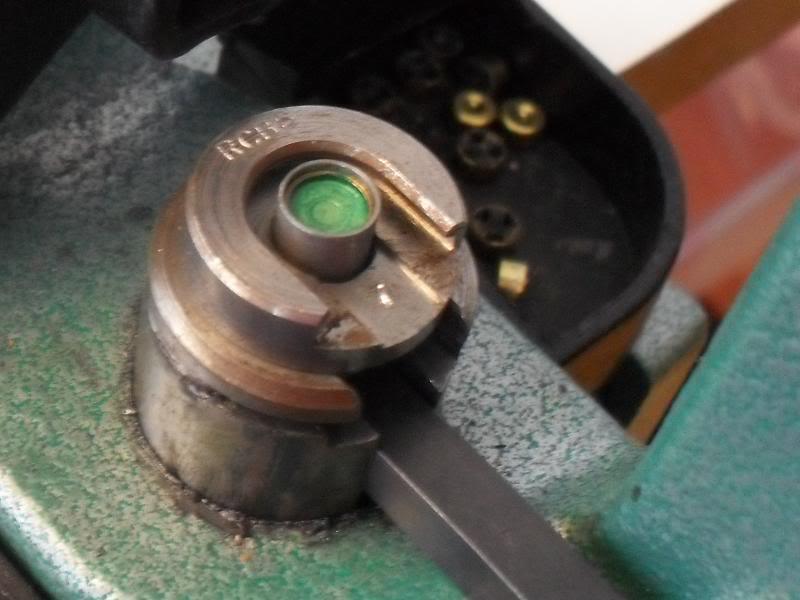

    After that it’s priming the cases.
    Because of the size of the primers I have to use an adapted shell holder and an handmade primer device .
    A good friend from the US made these for me a couple of years ago for which I’m still grateful.
    Adapted shell holder and handmade primer device.

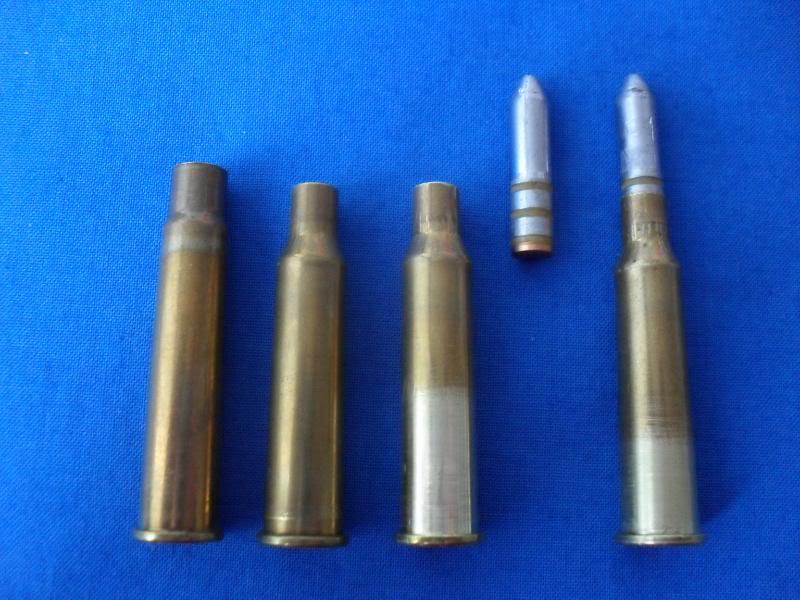

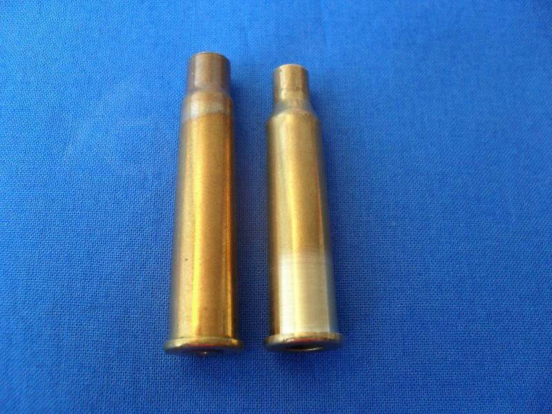

    Left: Dutch .303Br parent case.
    Right: Reformed to 6.5x53.5R Dutch (notice the adjusted diameter above the rim)
    Time to prime the cases.
    From here it’s just business as usual.
    Fill up the case, place the bullet and off to the range.
    Ready to go to the range.

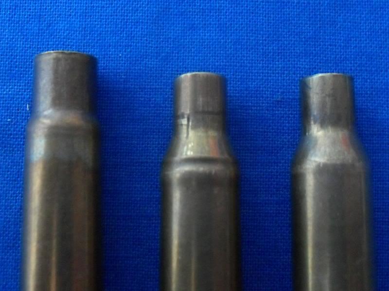

    Take a look at this picture.
    From left to right you see a Dutch .303 case, a .303 reformed to 6.5x53.5R and a fire formed 6.5x53.5R.
    It looks like the reformed case has a split neck, but it disappeared after fire forming.
    These so called oil dents are created by to much lube while reforming.
    Sometimes they don't disappear and most of the time the neck splits at these places after about 5 to 6 times reloading.
    Check the shoulder of the fire formed case.
    It fits the chamber of my Dutch Steyr Mannlicher perfectly now.

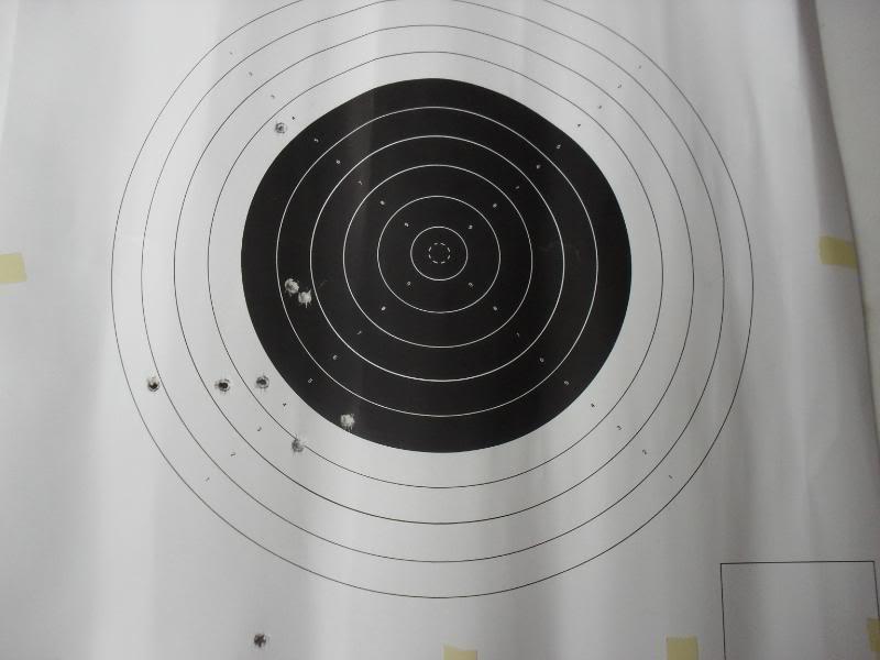

    Here's a picture of the target.
    My goal for that day was fire forming the cases, but IMHO this target doesn't look bad at all.
    First shot was way too low(not on target), second one still too low, third shot was too high but the rest looks OK to me.
    I have to adjust the front sight a bit, but the ammo performs great.

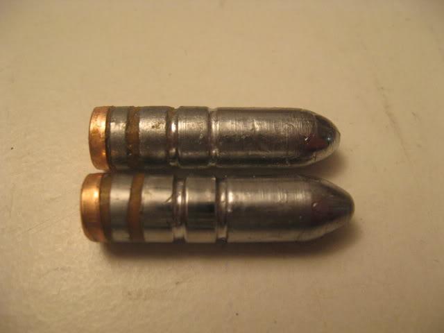

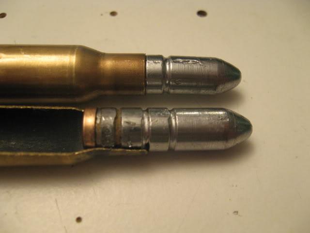

    Here's a picture of the casted bullets I use.
    The cal .313 fits my Mosin Nagant M91/30, the .311 my Mosin Nagant M39
    Cal .311(top) and .313(bottom) casted bullet.
    Not a perfectly casted bullet, but they fly great.
