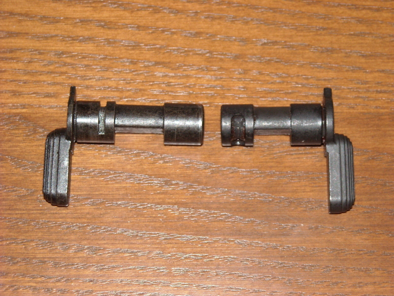

    AR180B safety on the left, AR15 safety on the right. This is where I give a shout-out to CGNer sigboy who was awesome enough to send me a spare used AR15 selector which made this little project possible.

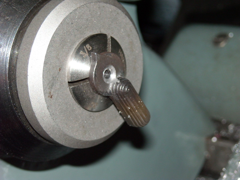

    I cut the tail off the AR15 safety leaving enough meat to grab in a collet (Hardinge 3C collets ROCK!) on the lathe to cut a clearance hole and a 0.190" diameter countersink using an end-mill held in a Jacobs tailstock chuck.

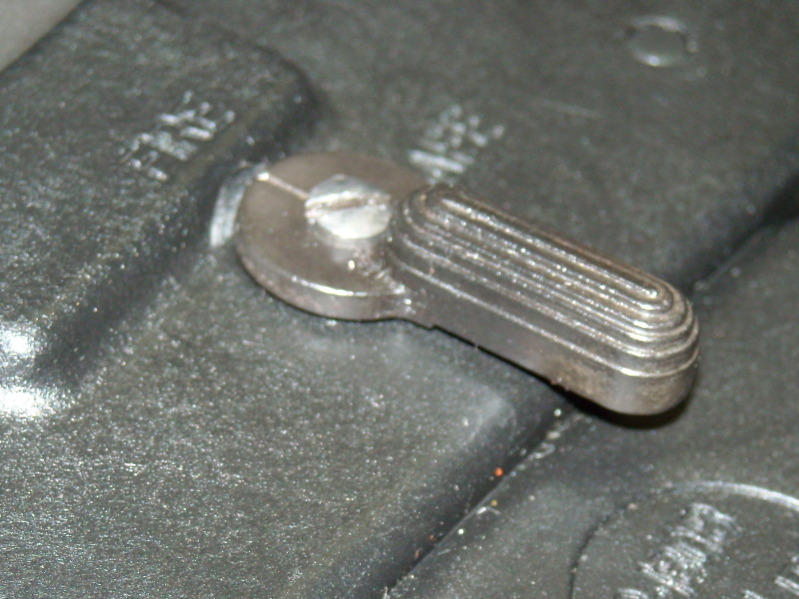

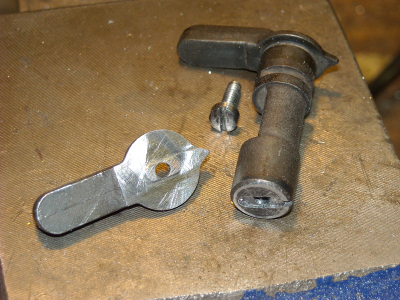

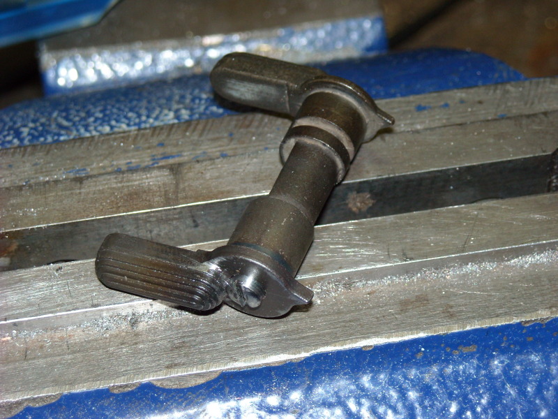

    I made an appropriately sized 4-40NC screw out of a larger screw on the lathe, though in truth if I had felt like leaving the house this could have been bought and the head turned to precisely fit the countersink. I also annealed the spare AR180 selector and cut a slot in the tip and drilled and threaded a 4-40NC hole into the centre on my knee mill. I also milled the back of the AR15 selector down flush to the circular flat skirt but left a slightly oversized tongue which I shaped with small files to precisely align and fit the tongue to the slot on the modified AR180B selector.
    Mocked up:

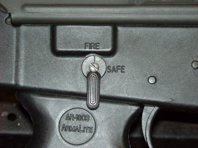

    Finally, because the AR15 selector skirt is slightly too large and interferes with the rectangular receiver protrusion where "FIRE" is written (not sure what that hump for???), I filed the pointing arrow off the modded AR15 selector lever and used the mill to cut a slight circular relief into the radius of that "hump". I then filed an indicator line on the skirt to replace the pointer. Finally, I re-hardened the parts (heat to red hot, drop in cold water) and re-parkerized them.
    I think it turned out well, though the screw I made didn't take the park as well as the selector bits. A minor inconvenience I can live with.
    Works like a charm
