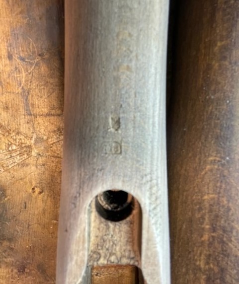

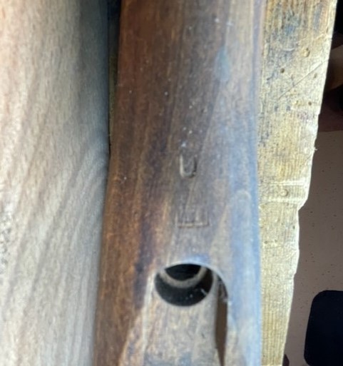

    Since I'm on a South African kick of late, South African No4 wood?
    Thanks to a buddy bird dogging them for me, I came into a pair of NOS No4 Beech No4 Mk1 forends on Thursday for a price so cheap the seller may as well have paid me to take them.
    After wiping off all the spiders, cobwebs and sunflower seed shells, it appears that these forends might be from SA.
    They are both marked on the bottom right in front of the trigger guard with a tombstone shaped marking with a three digit number in them and a U with something in the middle that I can't make out. Very similar to the markings on my NOS SA No1 barrel.
    Forend caps are marked CE1967, but that's all the markings I see beyond the wood stampings described above.
    Were these made in SA with English forend caps or do these sound like English made stocks with SA inspection markings?
    Thanks.

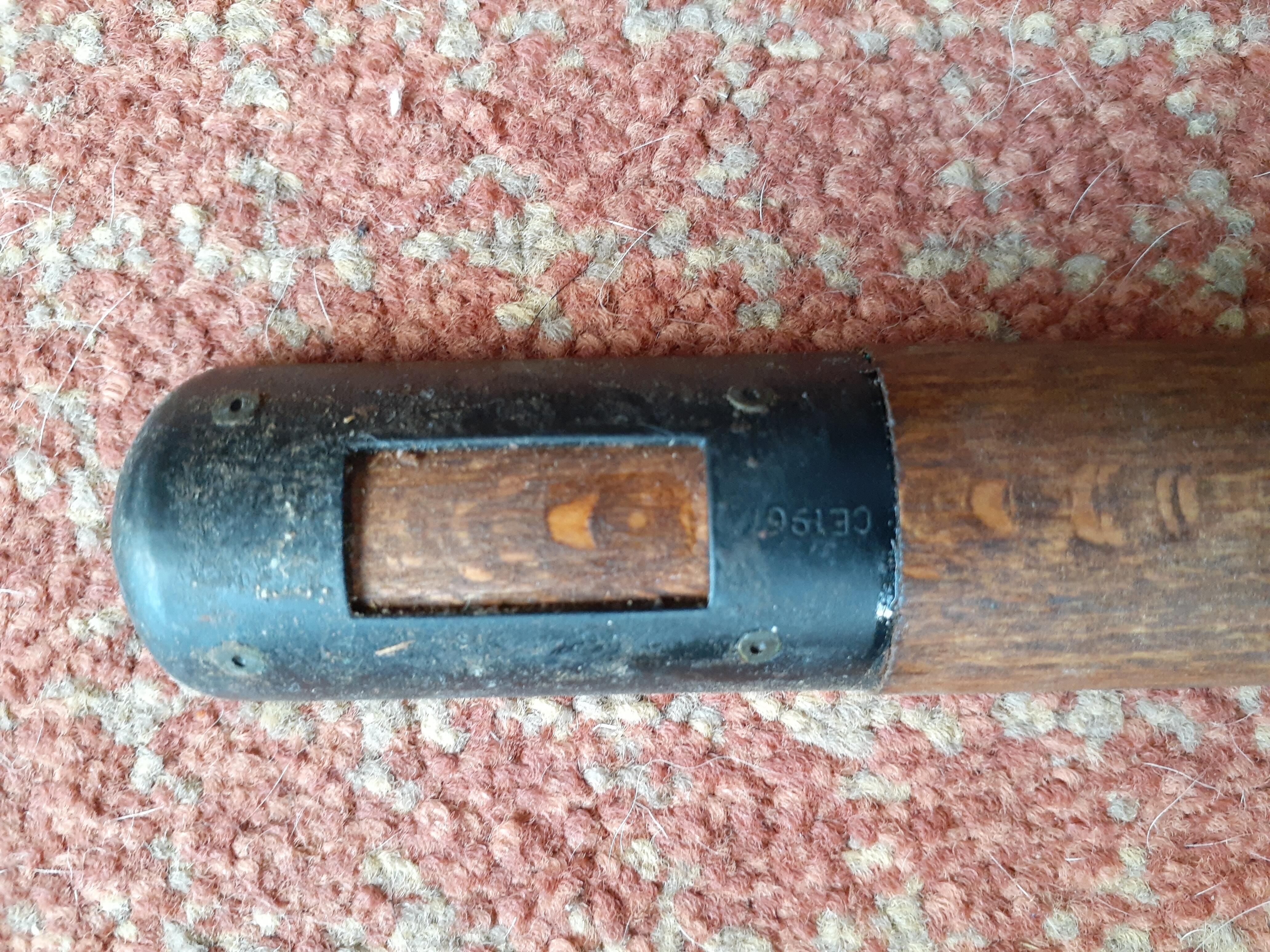

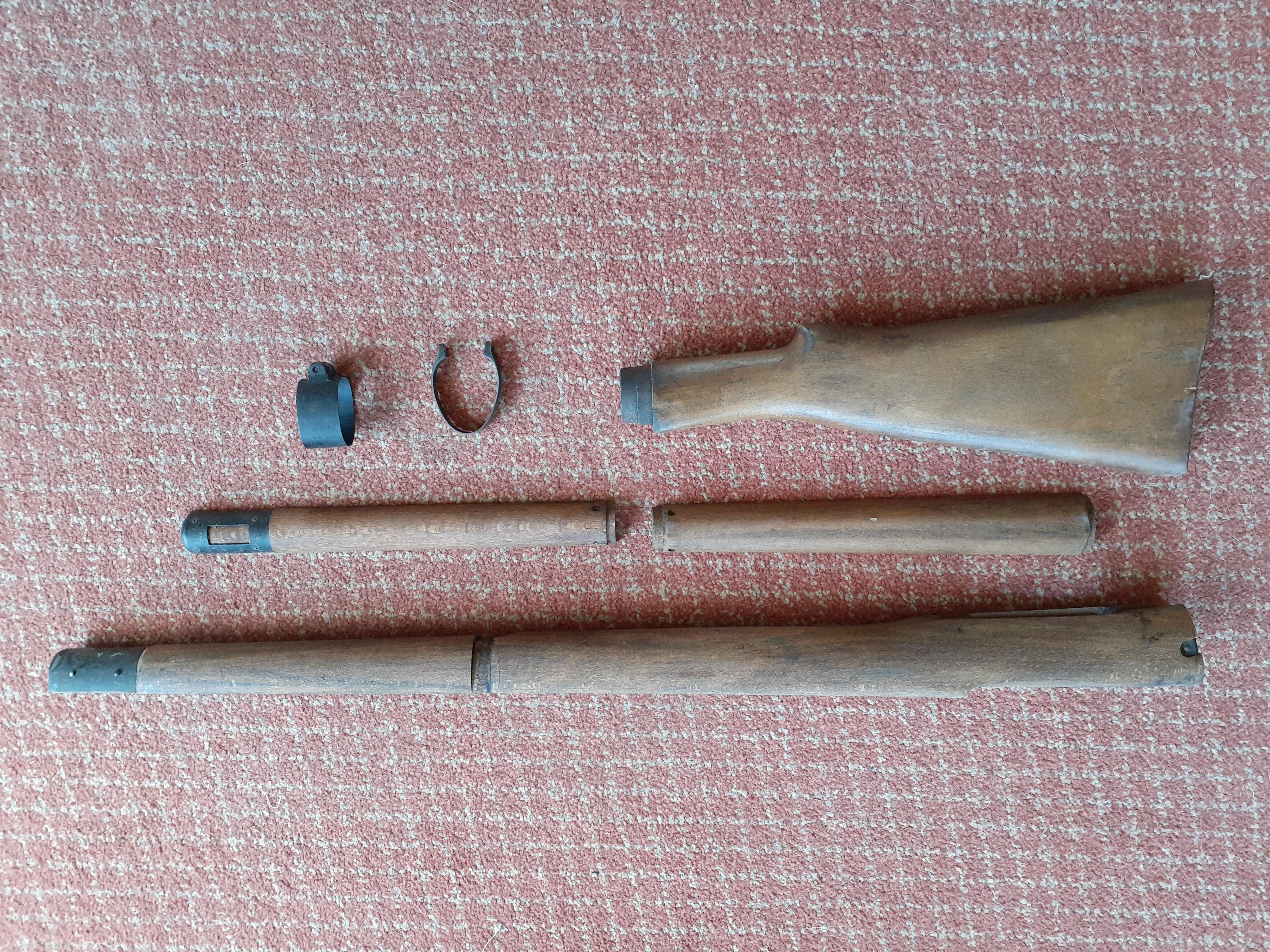

    Quote Originally Posted by Garandy View Post
    The "CE1967" furniture was made in 1967 in the UKicon for (allegedly) a contract with SA which was never fulfilled (apparently due to Apartheid and sanctions)
    The CE is for C E Welstead who made the metal components (wartime code S126) for the No4 rifles as their original business was the manufacture of metal framed window systems. They closed down in 1973.
    I do not know who produced the actual 'wood' parts, or assembled them.
    There have been 'thousands' of these 'sets' floating about in the UK & I have bought and sold 100s of these 'sets' over the years - my last 4 sets going to the 'Klondike' just last year'
    I was fortunate enough to find a warehouse full of stillages of these and could select the individual parts to be all 'colour / grain matched', and could choose the L length butt (more suitable for todays 'modern man' LoP) and another carton full of the metalwork.

    Tough to photograph, but here are the markings. Identical, but hard to see or get the camera to focus on unless you stand on one foot and hold your mouth just right.
