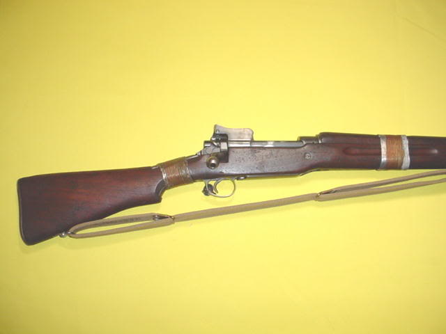

    Wire wrapped Pattern 17
    Britishicon produced Pattern 17 wire wrapped launching rifle....... Unfortunately you cannot see the red "none standard calibre" markings on the front handguard and end of the stock. The rifle is an very early Winchester Pattern 17, but note the reinforcing both on the rear of the stock as well as the barrel.

    Cord wrapped............ Yep, got two of them Warren! The cording was described as '..... pullthrough cord off the roll'. Presumably a roll of cord that could be used by quartermasters as pullthrough cord. Don't ask me how......, I suppose someone knew how to splice the loops in! The fact that P'14's are bound at the wrist makes the point that the whipping (with cord or wire) was in fact to reinforce the rifle as opposed to anything else
