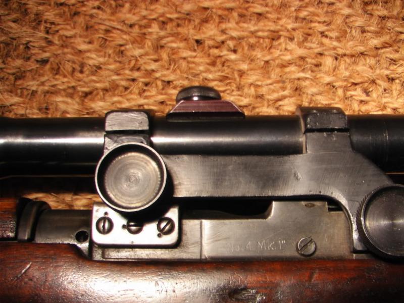

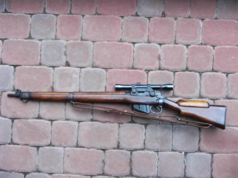

    Hello all! I'm new to the forum and Lee-Enfields. I have recently aquired my first No.4 Mk1. The rifle is marked on the butt socket M47 1943 AQ2902. The bolt serial number is also AQ2902. As the title of the post indicates this rifle is not marked TR nor does it have a T marked anywhere on it. I understand that this makes it highly suspect as a genuine sniper rifle. The strange part is the buttstock (with cheek piece) is clearly stamped S 51. I firmly believe that it has been attached to this rifle since day one. Also, the small 1/8" S is stamped on the right side, behind the receiver ring, just above the wood. The rifle has properly staked, matching finish, scope mounting pads, and scope mount with a vintage Weaver K4 scope mounted.
    Though the rifle looks like it's been well used, it still shot better than 1.25 MOA with the S&B ball ammo I used.This rifle was a real pleasure to shoot so I'm pleased with it no matter what. In fact, it is more accurate than either of my two WWII era Remington 1903's. What are the chances that this rifle actually is a sniper rifle?
    Check the England - Milsurp Knowledge Library for the representative example we have there, of an "all correct" 1944 Enfield No.4 Mk1(T) Sniper Rifle (Mfg by BSA Shirley - M47c), complete with a 130 picture photo montage of most of the markings and components you should see on yours.
    Hope this helps ...

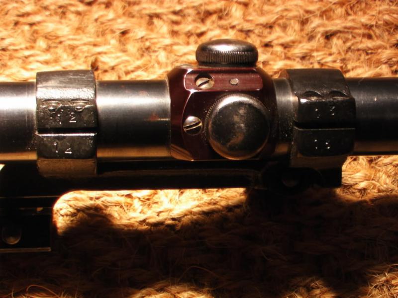

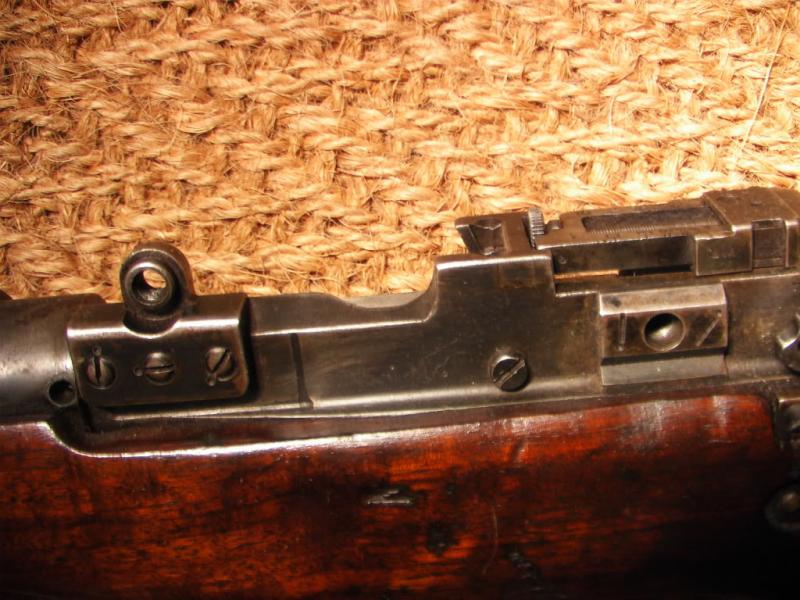

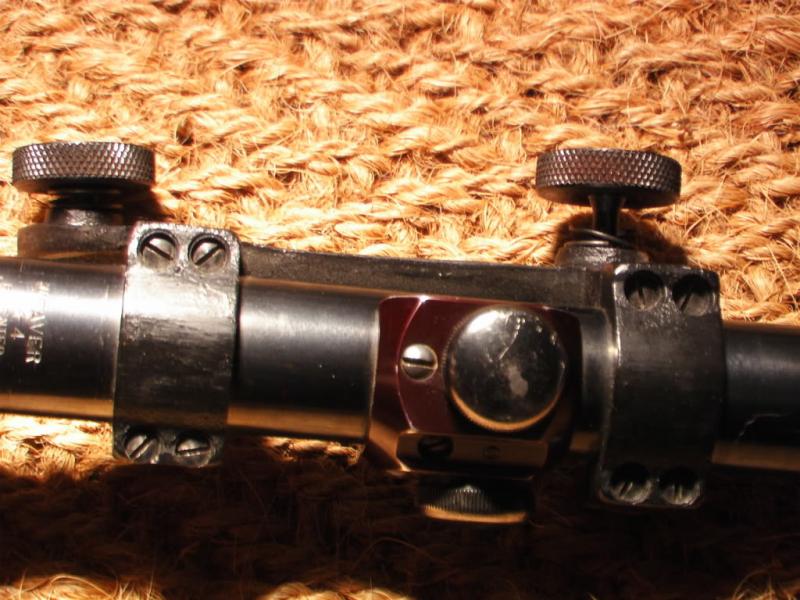

    The rifle looks original in my opinion and is most likely one that ran through H&H right before markings got standardized. The mount is questionable without more detailed pic's of her, and of course the scope is not original.
    Both pads look original with a later armour's stake job, the "S" is correct.
    If you can, take the butt off the rifle and see if the rifle's s/n is stamped into the butt on the butt socket flat. Also look for an inspector's proof mark stamped into the receiver near the butt right beside the bolt channel. Finally is there a visible scope s/n stamped into the butt by the cocking piece?

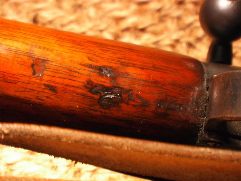

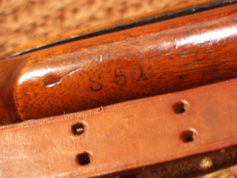

    It's a little known fact but when I was researching the little No4T book, I went through the Enfield examiners bench that seemed to be pretty well where and how he left it back in 1946 and took from the little trays a load of bits and pieces including three of the original 'T' stamps ....., (including one with a slightly bent leg of the 'T' if you have such a marked rifle) plus the original '51' of the S51 stamps. From this, you'll gather that the S51 was actually three stamps and not a single stamping so is almost never perfectly formed.
    Maybe one day, when my photography/camera is a million times better than is it, I'll stamp what I have into a piece of brass so you'll see the true stamps.
    The letter S was stamped by the H&H examiner when it came into the factory as an identifier. I have probably mentioned this too, but scattered around were boxes full of the ex P'14 butt marking discs with No4T serial numbers stamped in, barred out and others stamped in....barred out and so on and on. All long gone now

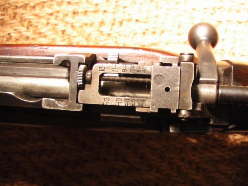

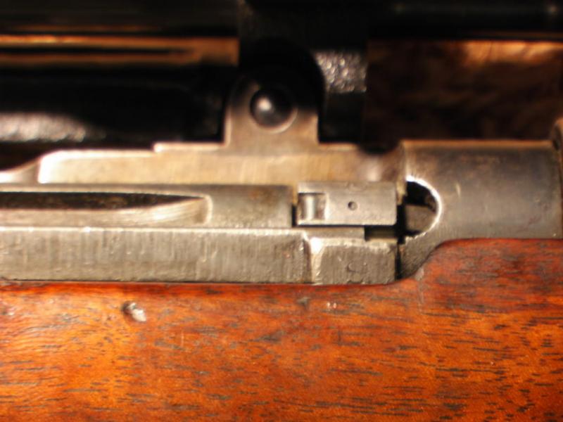

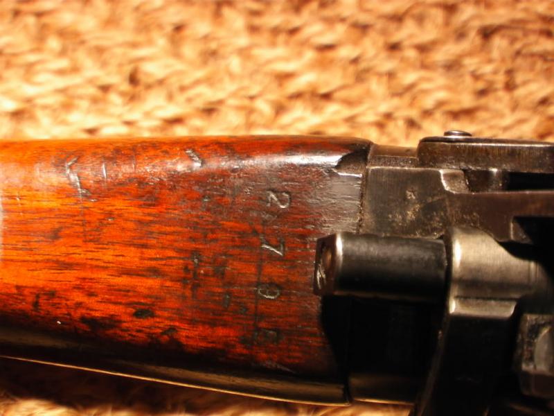

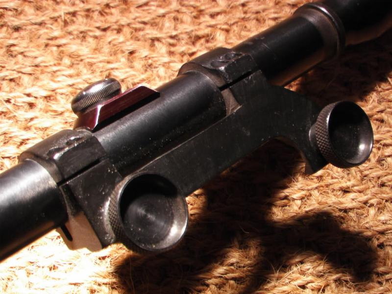

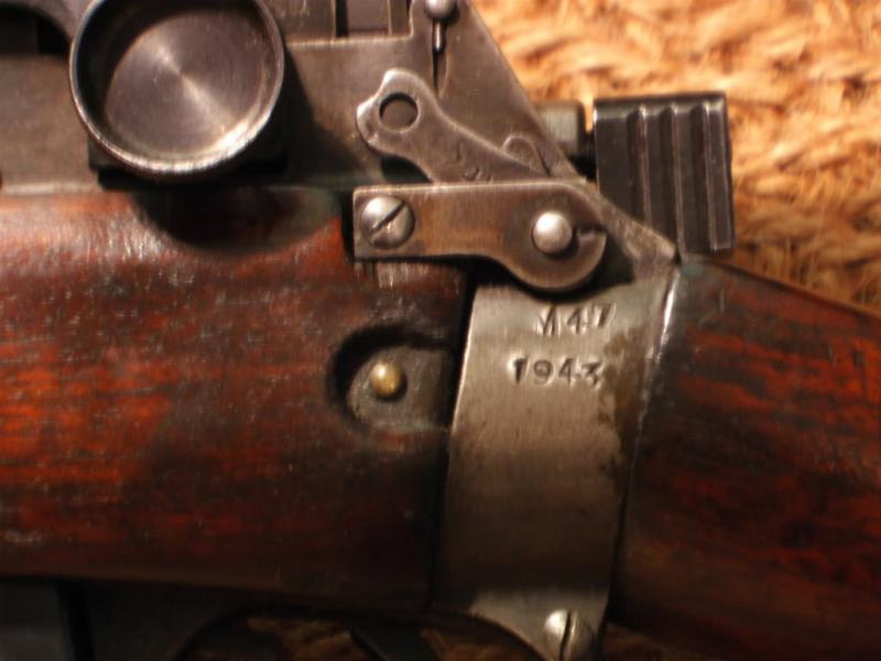

    First I have a bit of an embarrassing confession to make. I purchased this rifle at auction from the estate of Skip Stratton. At that time this meant nothing to me. Yesterday, after deciding to try to purchase some books on the subject of Enfields I had my "illuminating" moment. I had no clue that Skip was in fact Charles R. Stratton.
    I am reluctant to remove the butt. There seems to be a washer of some unknown material, cardboard perhaps, stuck to the screw. I'm not sure I can remove it without buggering it up.
    Here are a few more photos There is a scope number stamped on the stock 2795. Also there are two ** stamped on the left reciever near the stock and bolt channel. Underneath the stock behind the trigger is a six pointed star and a V. There are other smaller marks but I can't describe them. As for the scope mount, the only numbers or markings are on the right side top and bottom sides of the rings. 12 and 13 back to front.
