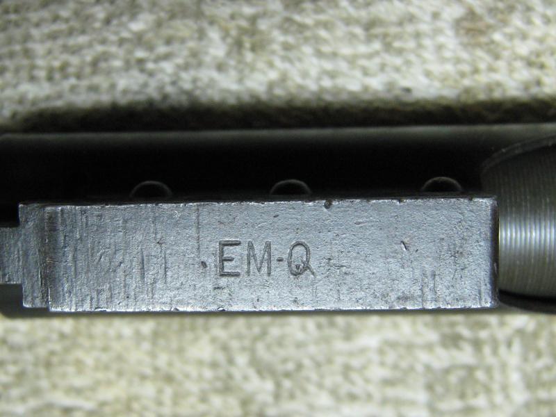

    Here is the SG Carbine I bought a week and a half ago. Can someone decipher the parts codes for me?
    The only mark on the bolt

    The hammer is Underwood.
    Trigger is Quality Control.
    Sear is Inland.
    Trigger housing is Saginaw Gear at Saginaw.
    Safety is Irwin Pedersen.
    Bolt is Inland.
    Front sight is Saginaw Gear later production.
    Magazine release is a late war replacement.
    Barrel band is a late war replacement.
    Rear sight is a late war replacement.
    Barrel is Underwood.
    Stock is Inland.
    Oiler is a post war replacement.
    Your carbine is a typical rebuilt and should be a good shooter.
