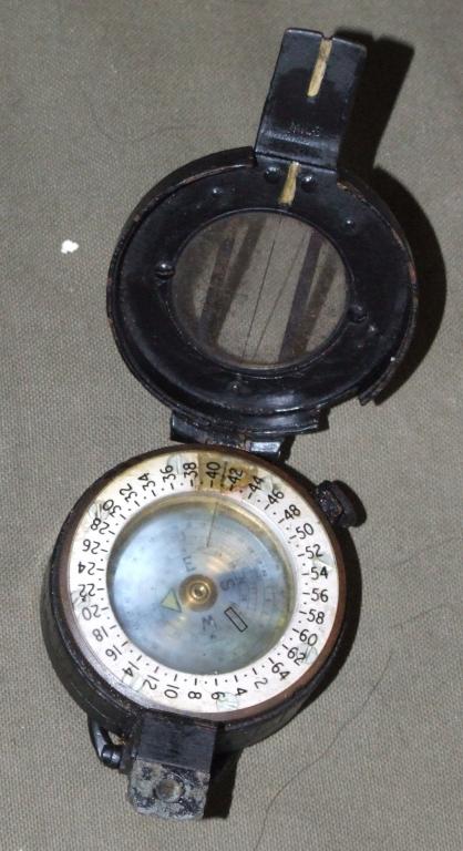

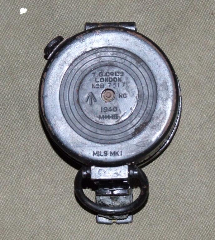

    Hello Peter , I found this one in the forest last month. it is a 1940 with prefix B . It is also already converted to mills .I tried to take it apart , but i wasn t able to get the bowl out .It has probably been there for some years , as the rubber is gone and the zinc part is badly coroded .

    WOW that's neat! Did it fall off a compass tree?
    Just kidding about the tree. I just wonder the amount of stuff lost on D-Day alone and if some one was tasked with searching and clean up? Might be a topic for a new thread?

    i guess it was left over by an exercisze . i was realy surprised when i looked down . But i wonder how long it has been there...
