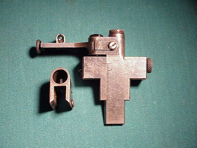

    Here's a picture of the actual sight. An interesting thing about it is the apature has flip down peep within a peep that you can switch back and forth to depending on what you want.
    Attachment 27453
    Kurt

    I could be wrong, but I think your sight is mounted on the wrong side of the receiver.

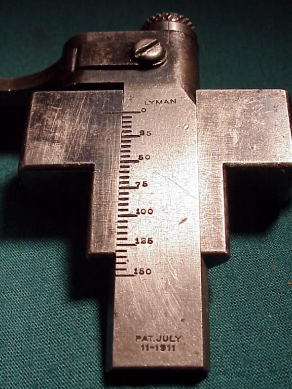

    I'm just getting the hang of this picture loading, please bear with me..
    This picture is of the sight on our rifle;
    Attachment 27456

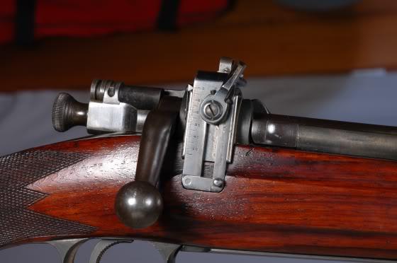

    This picture is the one in Brophy's book;
    Attachment 27457

    The Lyman 34 was used a lot on 1903's until the Lyman 48 was introduced in 1911. I don't see these very often on a 1920 vintage rifles. I would be very interested in seeing an overall picture of the rifle or you could call me and drop by the house with it. I don't get to say that very often ;-).

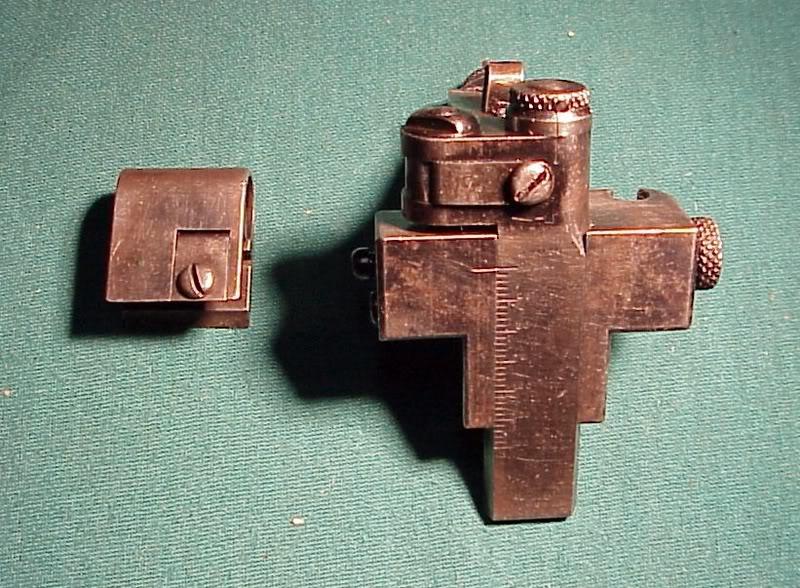

    ---------- Post added at 10:46 AM ---------- Previous post was at 10:38 AM ----------
    This is an early variation, one of five made for Ned Crossman, it has finer divisions and numbers.

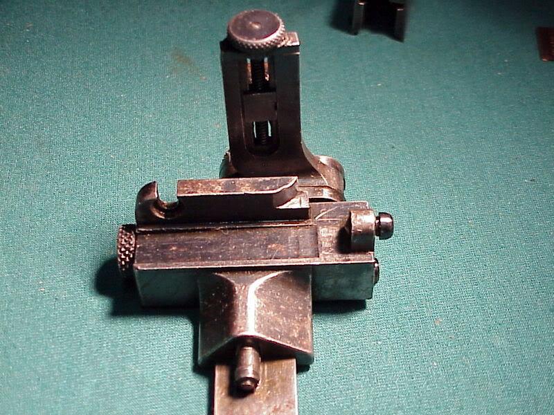

    Speaking of unique Lyman sights this is purported to have been made for the Argentineicon Navy Mauser 1909. I've never found anyone who has ever seen one of these or knows anything about it.
    The sight mounts on the bolt release and swings forward out of the way so the issue sights can be used.
