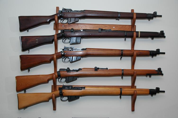

    Ok, after eight years I've got my Lee Enfield collection back. By most of the people here's standard it's a tiny group of rifles hardly worth dignifying with the monniker 'collection', but they are mine and I love them.
    Here's the list;
    No 4 Mk1 1942 LSA 2 groove very clean and shoots really well.
    No 4 Mk1* 1950 Long Branch with a very nice bore and a stock that's a bit dinged.
    No 4 Mk2 1955 Fazakerly unissued (The holy grail) that is a dream to shoot.
    No 1 2A1 1967 Ishapor that I have plans for because it shoots 308 and it groups tight.
    No 1 Mk3 1945 Lithgowicon unissued that I have yet to shoot but is very pretty.

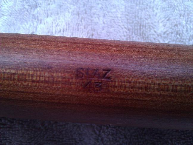

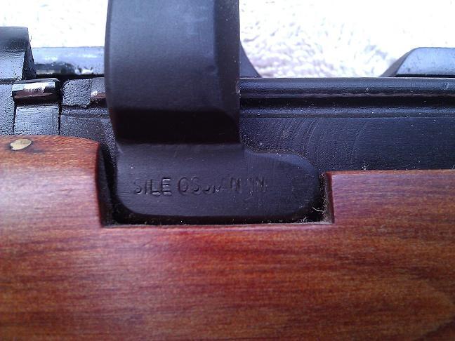

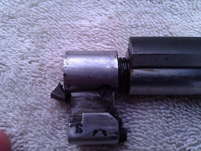

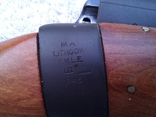

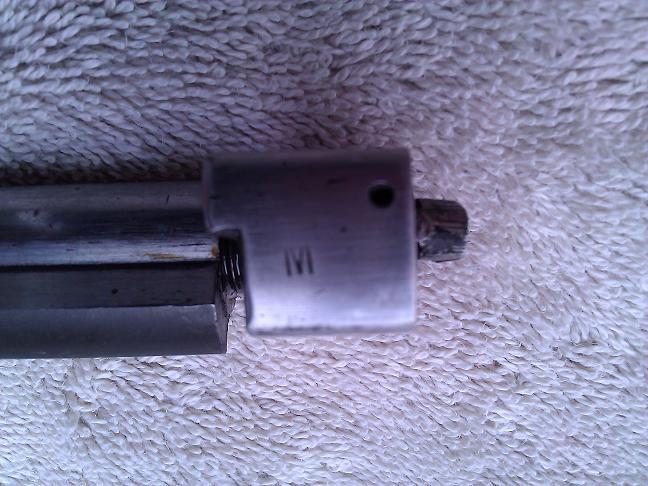

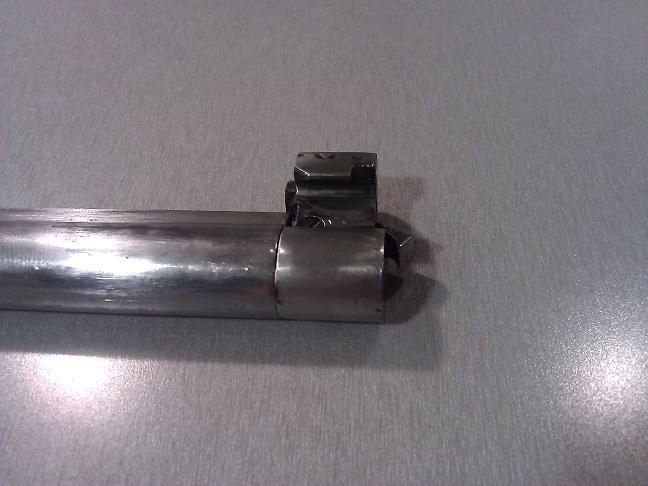

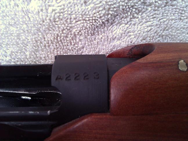

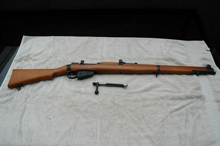

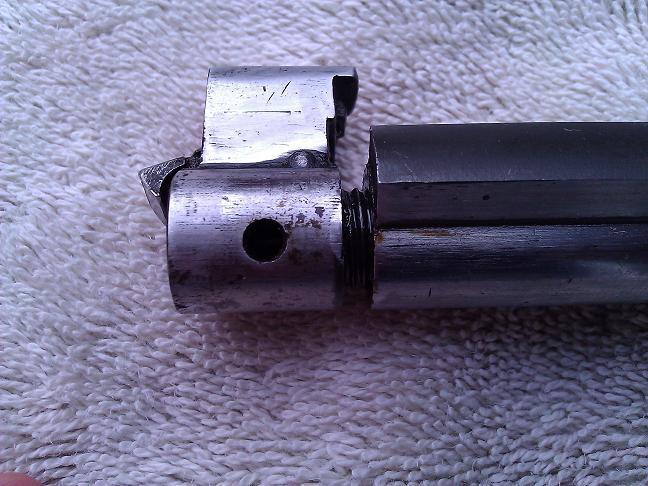

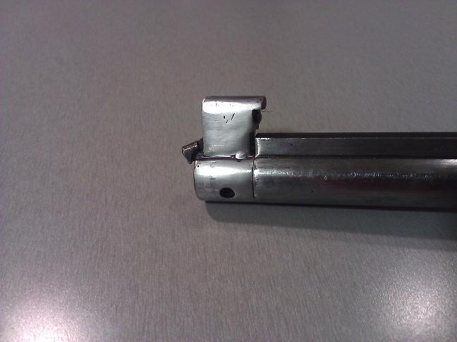

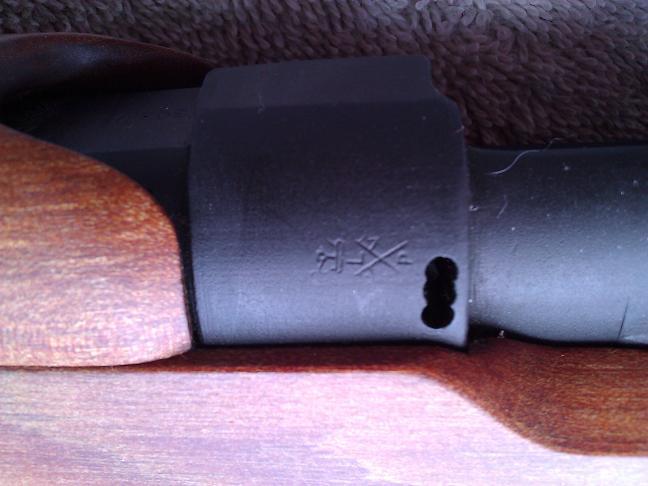

    Ok, many thanks for the points made regarding the Lithgowicon. It's definitly a ''bitser' the serial number is A223. The odd thing is that I can't find any other serial number cancelled or otherwise. For what it's worth I've included images of the markings and the rifle itself. As to the bolt the only scenario that I can think of is that the rifle was assembled somewhere hot which opened up the receiver tolerances. It's either that or it shrunk with old age. Last night I very gently tapped out the bolt using a nylon mallet with some terry cloth wrapped around the bolt handle. This is where I tapped it out. I was very careful/gentle and after about 20 minutes the bolt was free of the receiver. As you can see from the images there were some high spots on the bolt head. How they got there I don't know and I haven't fired the rifle and the barrel was definitly heavily filmed with cosmo. After cleaning the barrel it appears to have been unused. Where the bolt interfaces with the bolt body there were definitly some light ridges flaring out from the trailing edge of the bolt body. See the images. The bright spots are the points that were binding on the receiver as I was tapping it out. Also the end of the extractor screw was too proud and was also catching on the reciever. I used a Sharpie pen in lue of engineers blue (works a treat) to work out where the high spots were once I started to very gently grind the head (more polish really) with a Dremel with a small paper sanding disk. I stayed away from the bolt face and I removed a tiny amount of metal. It took me about an hour because I really didn't want to screw it up. The bolt now moves perfectly. Very silky and smooth. Like I said, I removed a miniscule amount of metal but I'd really like to know what caused it in the first place and how the heck did the 'armourer' get the bolt in there in the first place!

    What's that ragged metal on the bolthead in the 2nd last picture?
