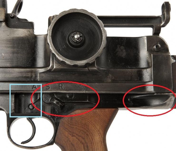

    Hi Alex, the real easy way (But not always possible) is to see if the original serial number is still present on the lower (and let us know). Next, look at the top (The bit that would be inside the gun if ftted) at the front above where the forward tripod lock pin is and see if there is a number code there. If there is, its Inglis.
    Ignore any that look like this as they will not be the Enfield Mk1m type. The waisted portion shown by the circle on the right is typical machining of early Enfield Mk1s, Daimler/monotype Mk2s, Enfield Mk3s (Plus Indian Mk3) and most of the Lithgows
    04-20-2025 @ 11:18 AM
    16,645
    05-04-2025
    11:53 AM
    Just a minute BP, AlexV had got a late Enfield Mk1A (the term Mk1M is a strictly for a Canadianicon gun.....) so he needs the sort your photograph shows around the change lever
