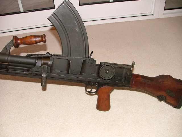

    I bought this many years ago at an auction in Saskatoon for about $45, and it wasn't until several years later when I got a copy of "The Bren Gun Saga" and my first Mk I Bren that I realized what it was. I haven't seen another one, but then I haven't looked. I don't know how common these are, but imagine that not a huge number survived. It's a fussy little piece......
    Ed
    Attachment 28921Attachment 28922Attachment 28923Attachment 28924Attachment 28925Attachment 28926Attachment 28927

    Good question Mr C, well put too! KevG, you're the expert in the 'object', you give em the full details. But very briefly, it was a fixed line sight. Not quite (or even nearly....) a dial sight for indirect fire but a nearly, sort of a baby dial sight. The problem was that it was neither fish nor fowl and didn't really do anything in the horizontal mode that the traversing stops didn't achieve more cheaply. In fact the fixed line sight on the 30 rounds-at-a-time Bren didn't do anything that a 250 rounds at a time fully dial sighted Vickers MMG couldn't do in a more fierce and ferocious way.
    Care to expand on that KevG and others
    Just a bit of history too. When you hear mention of a 'double dovetail' Bren, these are the very earliest Brens with TWO dovetails on the left hand side. The rear one contained the standard but oh-so-complicated drum type sight while the vacant front dovetail was to house the fixed line sight. But the fixed line sight proved to be frill, if not a complete fraud - and an ever increasingly expensive one. So once we'd had our backsides kicked out of Europe and needed to rationalise, the dial sight AND the housing on the left side of the Bren had to go. Thereafter, they were single dovetail sided or Mk1A Brens - except in Canadaicon, where they were called Mk1M Brens

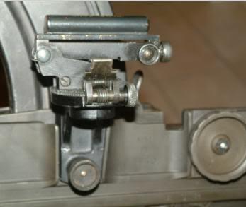

    THere's the sight fitted to the front dovetail on an early-ish Bren. You set the gun up on the tripod roughly for elevation then roughly for line, then cross levelled it all up with the spirit level, then reset it again, this time accurately for elevation and accurately for line. Then fired 30 rounds in short bursts at the unseen target identified on a map. In the meantime, the big boys further down the line had done all that work with their feared Vickers guns or, if you were lucky and the enemy even UNluckier, with the ferocious 3" mortars. Nowadays of course, you'd call in air support...............
    Yep, the Bren fixed line sight is up there with the best of them. Or should that be - with the worst of them? The saving grace of course is that like the magazine loaders, they are now worth a kings ransom

    Sorry, still haven't quite got it!
    Well Peter, I am familier with the artillery concept of aiming "over the hill" at something you cannot see, by using something you can see as an offset aiming point. Works best for a very curved trajectory. But a Bren surely, like a rifle, does not have much of a howitzer trajectory at usable ranges (OK, I'll modify that, some of my black powder rifles do have a howitzer-like trajectory!) So unless the enemy is conveniently lying still and unprotected well behind a very slight rise in the ground at an extreme range while you go through this adjustment performance, you can hardly "drop it on them". Or have I missed some kind of military fundamentals here?
