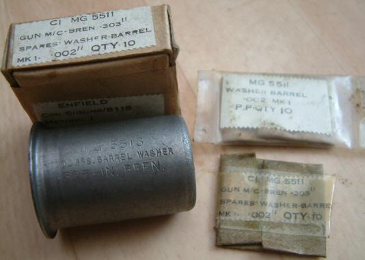

    Although tech details mention barrel shims in two sizes (.002 & .003) I have only ever found
    .002 barrel shims.
    Am I just unlucky or were the .003 shims done away with to only allow a maximum of two
    .002 shims ?
    Anyone got any .003 shims ?
    ATB Kevin

    We've got .003" shims and they were available. You could use up to .005" but unlimited (within reason of course) on DP guns as I recall. However, the use of shims on 7.62mm barrels was not permitted EXCEPT for the L55 DP guns
    The shim 'top hat' tool is interesting because we had to make one of those during the sheet metalwork phase of our apprenticeship. Mine was rubbish of course, looking like a ring doughnut!
