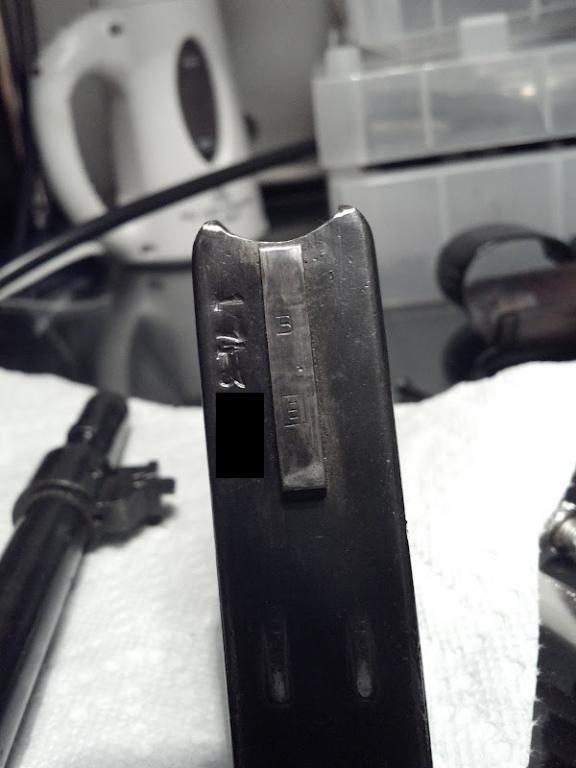

    The magazine has me somewhat stumped. There is a clear Savage marking on it, but the serial number matches the bolt & reciever (it is pretty poorly stamped), and there appears to be a B? or is it a LB? or is it just a 3? Any thoughts?

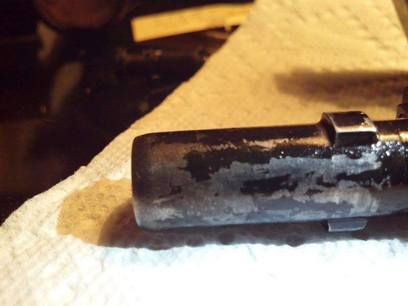

    The last thing I have noticed is that the tip of the barrel, the front sight guard, the stock caps and the front band all have some amount of flaking on the finish. Some of these parts are going to be replaced, but given the the barrel has a decent bore and an LB mark, I'd like to keep it.
    I know I'll probably lose some purists here, but what can I do to refinish this? It's really just the tip shown in the picture that I'm looking at, and really, it's as much about protecting the metal as it is aesthetics.

    Get all of the steel parts bead blasted, phosphated and repainted with a tough spirit based oven bake paint. Get rid of the big screw through the fore-end as per the detail shown in an earlier thread and finish the wood with a high degree of care. Now assemble the rifle carefully making sure that there's lashings of grease between the internal wood and the steel parts.
    There........... Now you have a refurbished rifle as it would have been refurbished and looked after by hard working Armourers of any nation. This is how it would have seen its extensive worldwide service of which it can be justifiably proud.
    On the other hand you could fit all the parts you mention, varnish the wood, blue the steel etc etc and have something like a car at concourse show or young but unreal girl on the catwalk or dare I say it, a yorkie dog with coffieured fur and a pink ribbon on its head. They LOOK good but bear no sebelance to anything that's ever been driven on the road or the attractive girl you see walking down the pavement. It's really up to you but I know what I prefer

    Greendoh....great seeing you take on a project like this. Yes it can be restored. you mag is "LB" mad and "S" issued...not uncommon so I would keep that. bolt can be restored. Take all the metal bits off the rifle that aren't LB, and replace with correct ones. Look for a very good ser of LB wood. Very rewarding to do this. i got most of the correct parts so you can send me a list to my email rgg_7@hotmail.com. Looks like your in Canadaicon which makes it easier to get the work done. Ron
