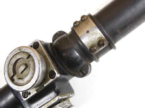

    Another interesting modification of a No. 32 scope, enjoy...
    eBay - New & used electronics, cars, apparel, collectibles, sporting goods & more at low prices
    WW2 NO 32 MK1 ENFIELD SCOPE WITH MOUNTS UNMARKED MODIFIED SOE ? ITEM?
    An original WW2 Britishicon No 32 Mk.I Enfield SPR Scope which has been made no markings and appears to have modified, possibly an SOE or some other covert use? Overall good/ very good condition.The scope came in with some other military items but really no much of an idea on this one so any information appreciated.Has all the fittings, shape, dimensions of a standard WW2 No 32 Mk.I Enfield Scope. However an alloy cover about 9.5 cm long has been added to the front section. Also the extenable eyepiece section has been taken.The scope itself is totally devoid of any markings, which is very unusual.A tiny amount of metal has been ground off under the scope and Parker Hale attachments have been added, probably susequent to the other modifications.
    We have also shown this modified unmarked scope which is for sale with an unmodified No32 Mk 1 Scope from our own collection for comparison which is NOT for sale.At least until we need the money!
    The "T" shape hairs and the whole vision of the scope is nice and clear.The side horizontal adjustment turrett clicks round nicely and the side moving adjustment of the "T" shape hairs moves well. The side horizontal adjustment turrett clicks round nicely but seems to miss a coupal of clicks and am not sure the side moving adjustment of the "T" shape hairs moves across its full range. Otherwise a rare item in overall good / very good condition.
    Last edited by Badger; 01-29-2012 at 02:18 PM. Reason: Edited post to add auction details and pics to save data for research and posterity

    Is it normal for the turrets to be alloy? Both of my Mk1 scopes are bronze.

    Doesn't it just make you want to spit when Scope Bubba isn't content with just removing the anti-rotation peg under the turret assembly (a 4 BA grub screw), but he has to completely destroy the whole housing by grinding/filing it down......

    I've seen them done up this way for target shooting. I had one some time ago that had the ocular lens bell extended to increase the power. Rings are bog standard Parker Hale rings. The target boys have no shame and will do anything to squeeze that last millimeter of accuracy out of a rifle an scope.

    No markings....... I bet it's an early Watson with shallow engraving. Go over it with a micrometer and you'll find that they've been sanded off
    Seen a few like this so if you're thinking of buying it, be advised that some have had the OG/front end of the inner tube hacksawed off to suit the special SOE(?) optical arrangement. You can fix it by accurately undercut machining and fitting the front............. anyway, to save myself a lot of writing, it can be done
