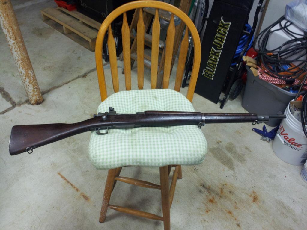

    Hey guys new guy here on the forums been lurking for awhile now reading up. But i just picked up a Remington 1903a3 S/N 42059xx, a RA barrel 8-44, 2 groove. The barrel looks clean and shiny. I measured muzzle wear with a live round(prvi 150gr) and have about 1/16" of copper showing, what does that translate to in terms of wear, 3.5-4? I know its not the proper way to measure it, just want it to be a safe shooter. Anything i should look for or be aware of before shooting it? It appears to be a Greek lend/lease? Vibropeend last 4 #'s of the s/n on bolt handle, and stamped in the right buttstock to. It also has stamped FJA on the left side as well as RIA EB in a box on the left buttstock. I will post up some pics later, i hope you guys will be able to answer my questions and shed some light on what i have.

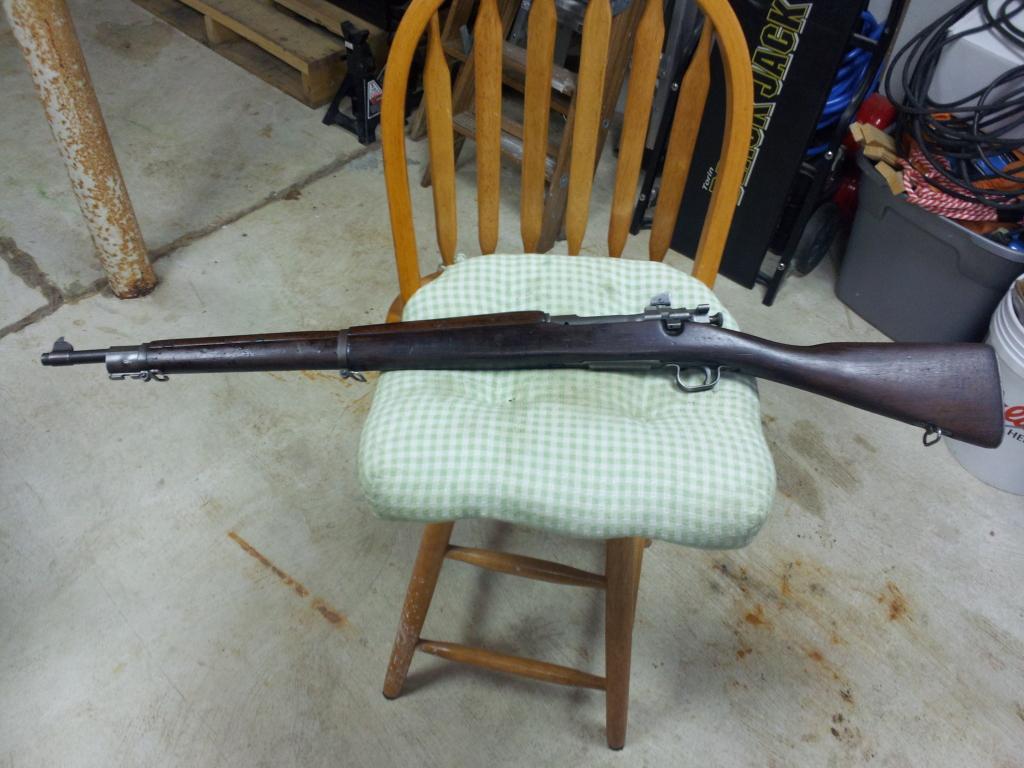

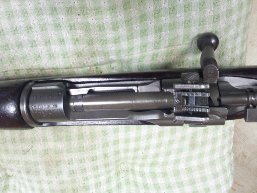

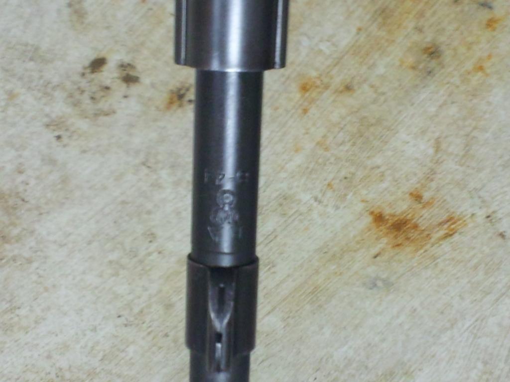

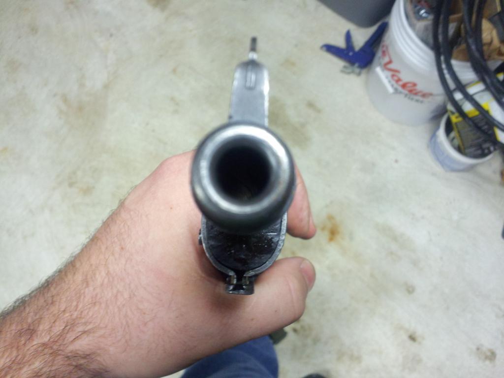

    Heres some pics i will try to get some of the bore and crown. Hard to get a pic of a rifle this long with a cellphone! Anything you guys see wrong or an info you can give would be appreciated. I got a pretty good deal on it so i hope i did good.

    Is the rear sight bent or is it an optical illusion?

    I looked at that too. It is just over to the right and the angle i had the rifle sitting at when i took the pic. I moved the sight alll around and it is fine. atleast appears to be. will know for sure after i shoot it.

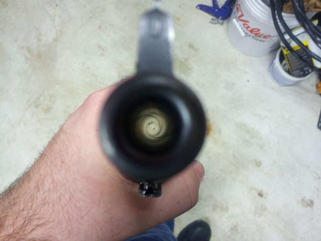

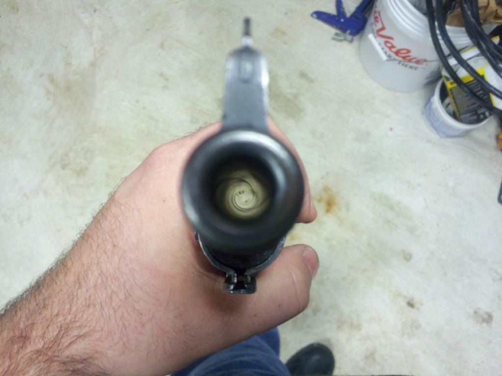

    Pics of the bore and crown, best i could do with cell. Battery charging for digi-cam. Its a 2 groove like i said before. I can clearly see the rifling go all the way from the chamber up to the muzzle. Seems ok for a 70 year old rifle! Looks like a shooter to me! Anything i may have missed? Any input is welcome! Plan on shooting some 150gr. to test her out.

    Looks great!
    Enjoy your range time.
    Don't forget the pics.....
