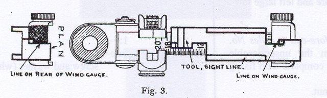

    How is the "Tool Sight Line No. 2" used?
    How is the "Tool Sight Line No. 2" used?Attachment 30919

    I have got a funny feeling that it was used to centralise the old windage-left/right adjustable backsight cap when the backsight assembly was modified by rivetting the cap to the leaf. All of the old ex-adjustable ones I ever encountered on DP's, EY's and in service with School Cadet corps had the cap and leaf rivetted together. But I could be wrong

    To re-line the windgauge or cap of the backsight of rifles No.1:-
    The tool, sight line, and scriber will be used in the following manner and as shewn
    First re-brown the windgauge, assemble it to the No.1 “A” sight leaf, and adjust it to its central position, i.e., with the original top centre line (now browned over, but visible) in correct alignment with the centre line on the leaf, and with the windgauge screw spring engaged in a notch in the screw-head. Next place the sight line tool over the windgauge and leaf, and see if the lines on the windgauge are in correct alignment with the tool; reverse the tool to verify. Then, with the scriber (which should not be too sharp), trace over to brighten the lines at the front and top of the windgauge, reversing the tool as necessary.
    The above instructions, so far as they apply, will be followed when re-lining the fixed cap of the No. 1 “B” leaf.
