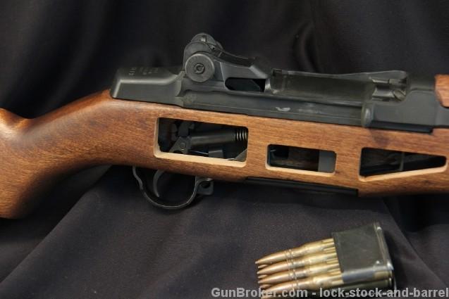

    Gun Broker Auction Pic below

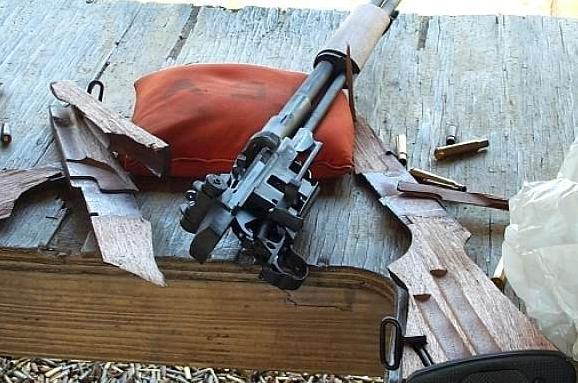

    Home made one below

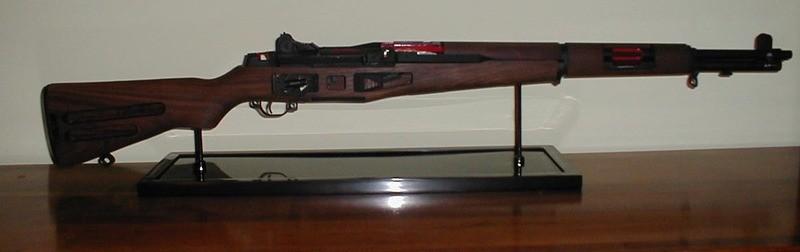

    Another non factory

    There is or was an outfit here in NC that used to make a cutaway if you provided a receiver. I thought this current auction rifle may have been built by a private enterprise due to the type of cuts and the lack of paint on the cut surfaces of the wood.

    The cut-away M1icon on Gunbroker was made by a private party. I know the maker/owner of the gun. It is very nicely done.

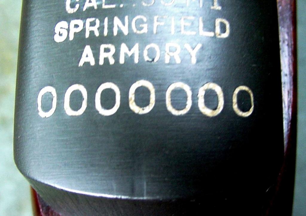

    0000000
    Here's mine with seven zeroes -- it's not a cutaway. Barrel is 2-44 and parts are all consistent with that. Tiger-striped stock with no cartouche. One just like it came up for auction 15 years ago, so SA evidently made several. I'm guessing it was a "Board Gun" in which all the parts were fastened to a display board, then assembled when SA closed. BTW, this was the rifle featured on the cover of the Man At Arms magazine with my article on collecting the Garandicon.
