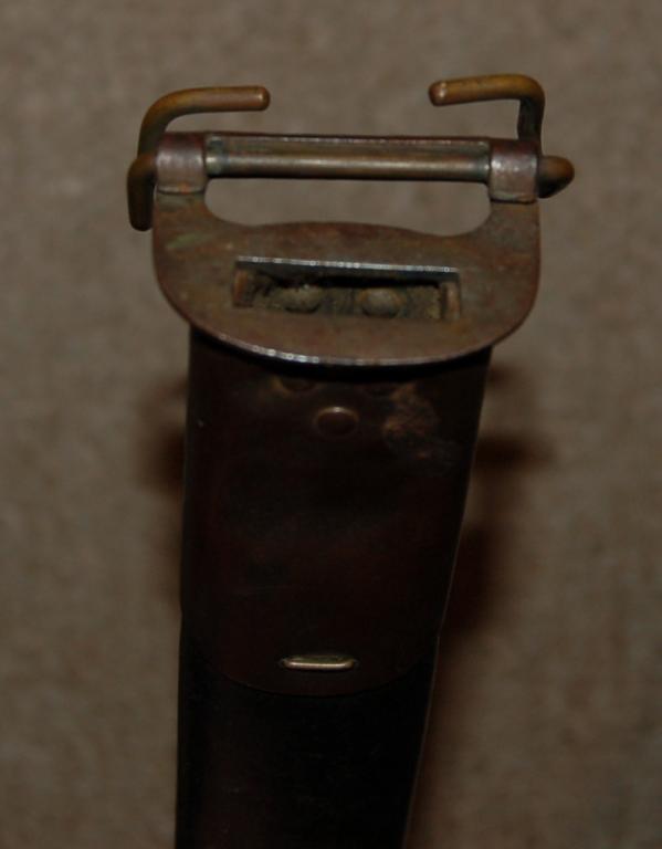

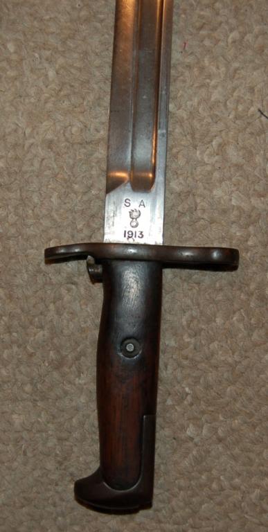

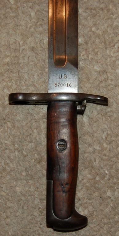

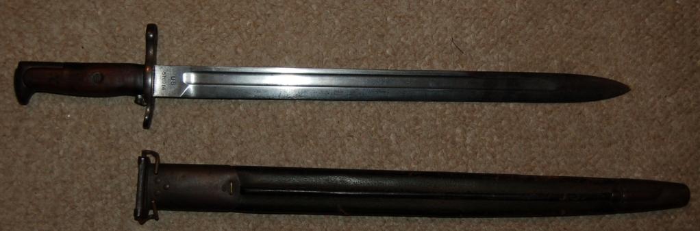

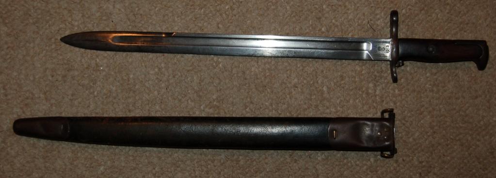

    Went to a small auction this afternoon and came home with this. Appears to be in good condition with the exception of a bent quillon. I've looked at quite a few photos and only came across one other that had a bent quillon so I'm assuming it's damage and not a production type. Scabbard could be better, appears to be a first type 1917 with movable wire hanger.
    My questions:
    Is it original and not a reproduction?
    Should I do anything with the bent quillon?
    Should I move the scabbard onto my 1917 bayonet and look for another one for this? I know they were issued for the 1905 in 1920 so it is more or less legit. I don't have a scabbard for my 1917.
    Fine steel wool the surface rust or leave it alone? Blade is fine, no rust on that it's the crossguard and pommel I'm concerned about.
    To be honest, this is a bayonet I never figured i would own due to the going rate for them so I'm hoping this it original. Looks like the real deal to me but I'm no expert. Serial number matches up with year of manufacture.

    That one's as good as they get. The bent quillion isn't unusual and I'd have it straight in a heartbeat. They're durable and it can be done without damage. The scabbard's correct and it's just one of the ones issued. Not the early one but you're going to pay huge for the 1910 scabbard. There's a pic of heavyweight fighter Joe Louis in uniform for the second war and he has a 1905 in that scabbard. They're legit. Don't do much of anything to that whole affair, it's a good looking rig.

    Excellent buy and the condition is VG +, as said by BAR, they guard can be straightened but I don't know that I would bother.
    The scabbard for the M1917 bayonet and is completely acceptable as a scabbard for the M1905 bayonet. With the loss by damage and wear, the M1910 scabbards were becoming scarce post-WW1 and in the early 1920s, the US Army, ever mindful of expenses, designated the M1917 scabbards as substitute standard for the M1905 bayonet and they continued as such for as long as the full length M1905 bayonet continued to be issued though they were replaced with the new M3 fiber scabbard as soon as possible when issued during WW2.
    A quick note, your scabbard is a Second Type for the M1917 bayonet. The First Type had a "D" shaped leather hanger folded over the same standard double hook then riveted to a steel block attached to the back of the top mount. It was not very durable and as production continued, the Americans changed the hook attachment by modifying the throat opening as you see in your scabbard, it was much more durable. For great information on the US M1917 scabbards see Article #11 in Gary Cunningham's "Bayonet Points" series at:

    Thanks for correcting me on the 1917 scabbard. I read one article that said the type one had a movable hook and the type two had a fixed hook and this one moved. No mention of leather attachment.
