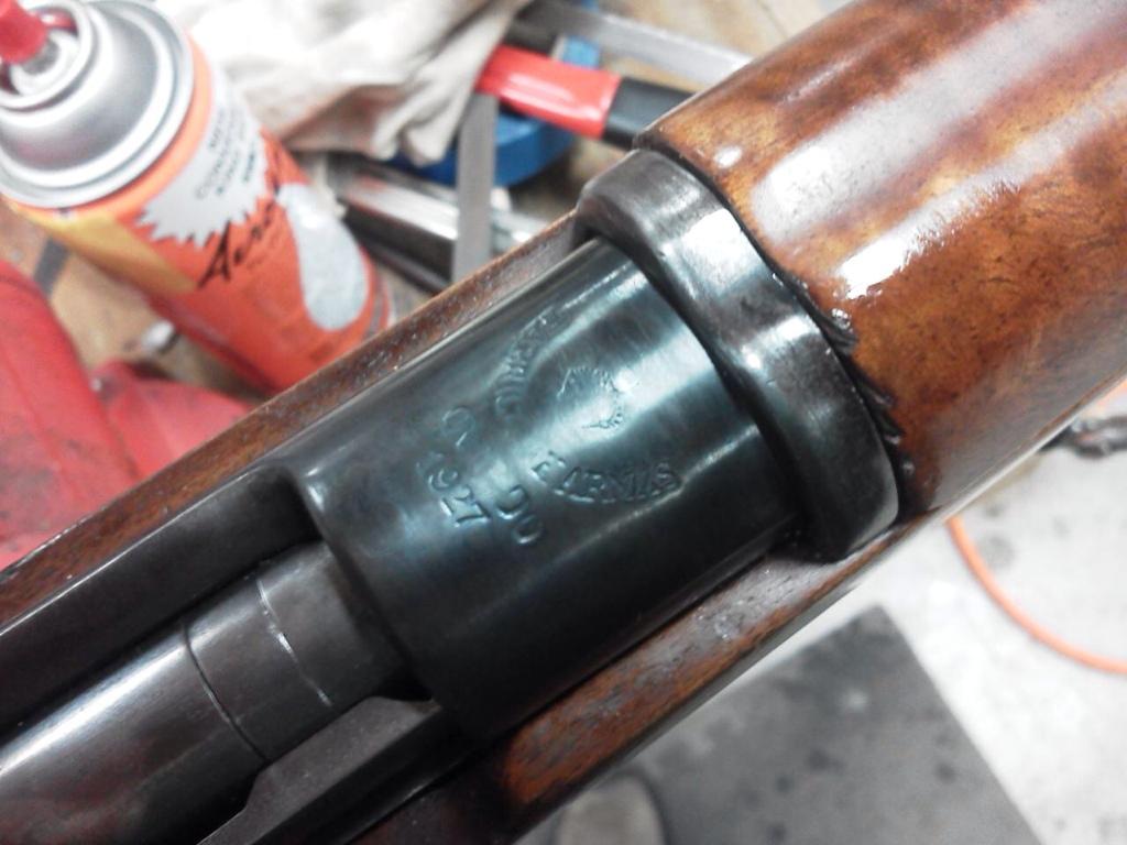

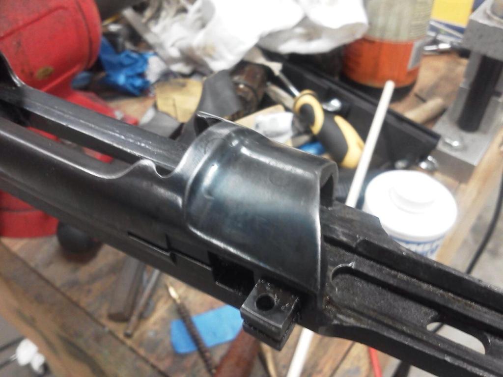

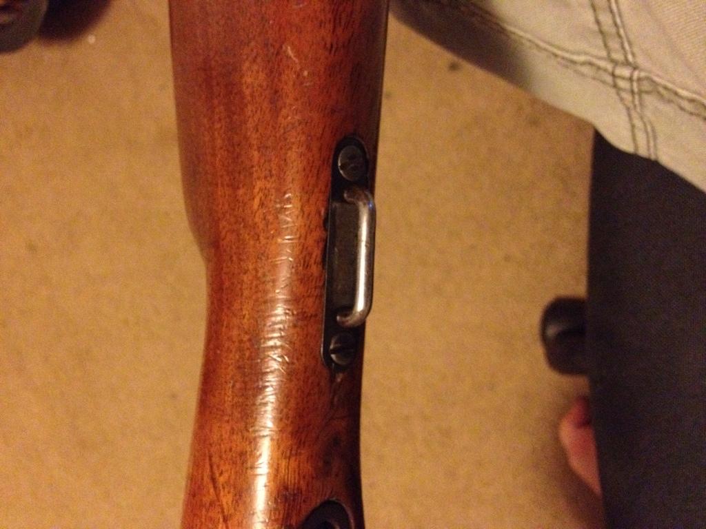

    The rifle, in full stock, missing only the saddle ring and bar, and the butt sling bar. Oddly enough, bubba had filled these two places in and where he had removed the sling bar, he installed a sling swivel stud.... So that was interesting.

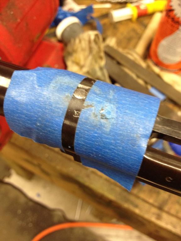

    The biggest bummer, however, stuck out like a sore thumb:

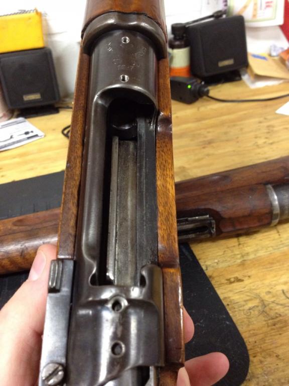

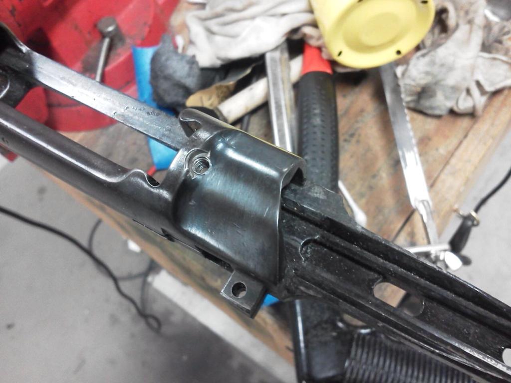

    Sorry there aren't any pics of the whole rifle before the restoration began but I am sure you can just imagine. So the biggest problem was the receiver being drilled and tapped. The stock I knew would be an easy fix, but the drill and tap took some thinking. Wanting to avoid the hazards of welding and such, we decided for something a bit more creative. Let me preface all of this with the notion that in all reality, this was sort of a practice for something a bit more valuable and no matter what, this rifle will always be a salvage piece, no matter how well it came out. Now, back to your regularly scheduled update:
    We decided we would use screws to fill in the holes and then polish them off along the top of the receiver and match the contours. This was a great idea and only had two complications. The forward most screw had missed everything but the crown so we needed to be extra careful there. Additionally, the third screw back was conveniently cut into the charger bridge which made imaginable complications. Regardless, It came out really well. Used a bit of heat and cold blue to touch up the finish after.

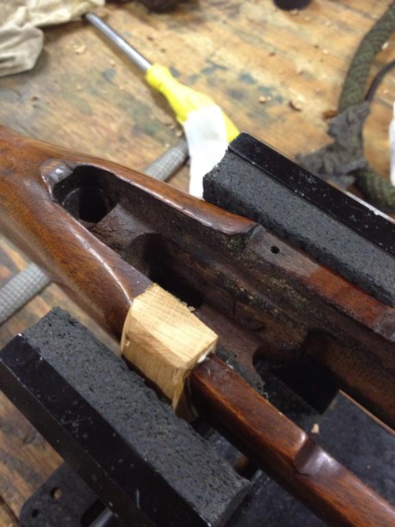

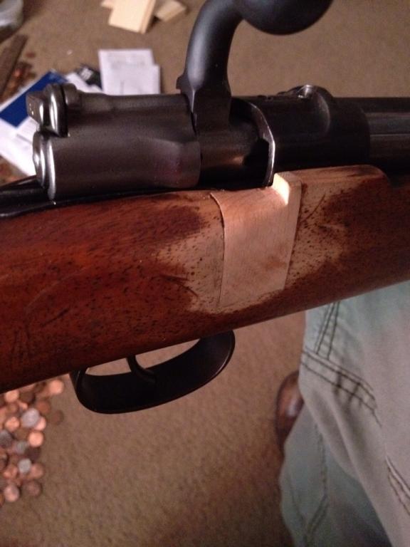

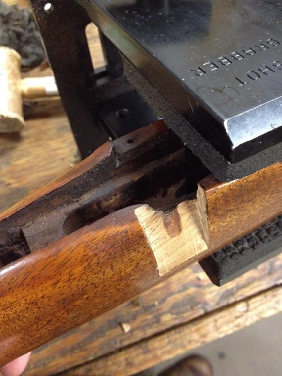

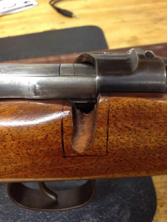

    Next was the wood which looked something like this before:
    They ofcourse turned down the bolt for that cut out so I had to replace the bolt body... Ugh
    During and After:

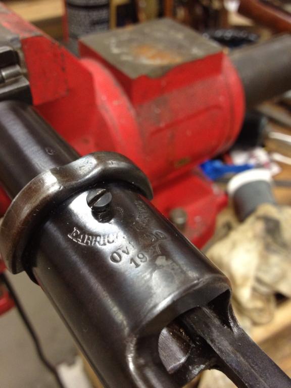

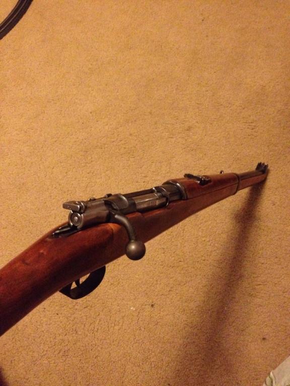

    And now, a sort of up close picture of the final product:

    More detail on the metal work. I took the drill press to it to install Countersunk screws so there would not be a half moon where the threads surfaced. As for the lump where the charger guide was I used an oversize Fillister head screw and spent some time with a file, Drimal and Dyechem to try and fit it as best I could. It did not help that Bubba apparently used three different sized drill bits to make the hole I was trying to fill.... Screws were installed using Rocksett Engineering Adhesive. Finish used was a mix of cold blues with just a dash of browning solution. As a final touch I used an engraving chisel to finish out the top of the crown where Bubba had drilled through it. Now if M4A3Sherman would bring her back to the shop I will install a saddle ring on his sling bar.
