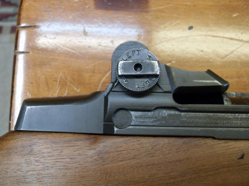

    Other than the stock and some small parts such as the follower rod, the rifle appears to be pretty much correct. Looks like it has a short pinion lock bar and marked sight cover.

    Joe, I think $1500 is too much, must have used oven cleaner on the wood but only the fakers can put the cartouche back on. Without more photos it is about impossible to tell if anything is original or a mix-master inside. On the rear sight lock bar ? any idea as to the type?

    Robert, Looks to be a "short pinion" what do you think ??

    Joe, That is a Type 2 lock bar with a sleeve that was threaded to the smaller 6-40 thread. Are there any photos of the internal parts ? RCS

    That lock bar would have fooled me.

    That sleeved Type 2 would have fooled me. Is that done to make it appear to be a "short pinion" ?? Joe

    Joe, The fakers normally do a better job of installing the sleeve, sometimes you need a magnify glass to spot the sleeve.

    I am not seeing the sleeve, blow it up to 400%

    Mark, I could be wrong, I know the Type 1 lock bars have been faked by using a sleeve in the Type 2. I know a collector in MN that bought a mid '42 rifle from a well known dealer that had the fake Type 1 lock bar.

    Do I see early SA recess behind op rod right side,,,,,,,,,,,,,,,

    I don't see a broad-arrow property mark, and the Crown/BNP is normally a blob on the bolt and receiver. I don't think there is a shot of the front of the receiver.
