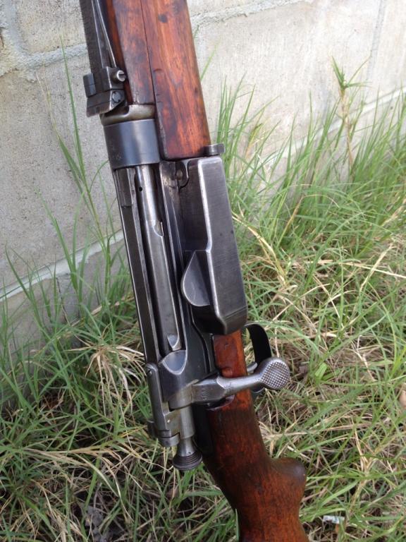

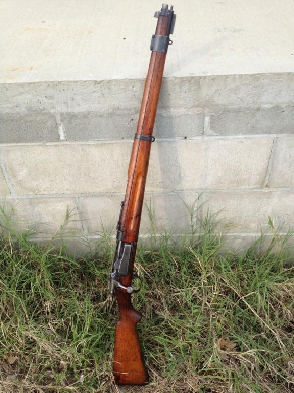

    HaHa! It is finally here. Been a long wait but I think she's well worth it! Can't wait to shoot her!

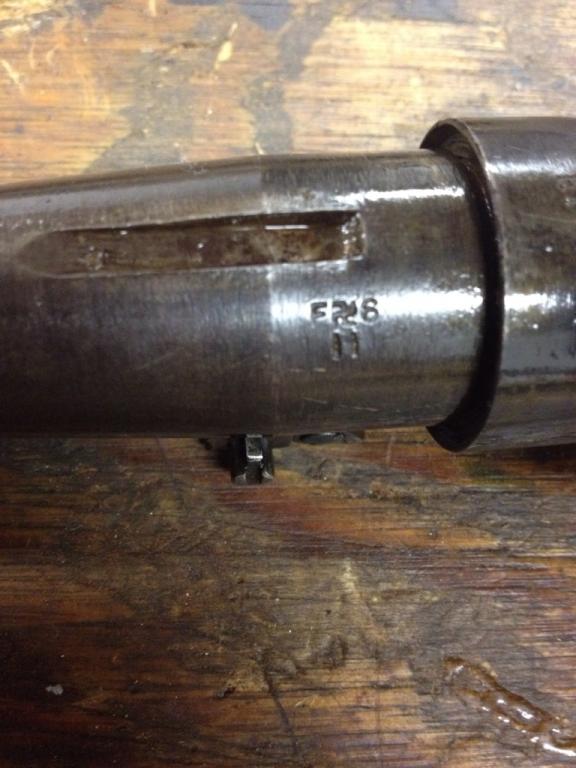

    Odd marking on the underside of the barrel:
    I know that not all swastikas are nazi related, in fact its probably quite the opposite, but anybody have any idea what it means or signifies on a Norge Kragicon? By the way all the numbers match, every dad-blame one of them! [glowing]

    Perhaps rebarelled during the Nazi occupation of Norwayicon. They had control of the arms making.

    Perhaps; but it doesn't look like any Nazi proofs I've ever seen before, as much as that would be really neat and add a little to the gun's value. The Nazi reworks and issues I've seen, of which there have been very few, were marked in the normal fashion with the firing proofs and other waffenamps.
    I wonder if it's just a Nordic thing, maybe just a big coincidence...
