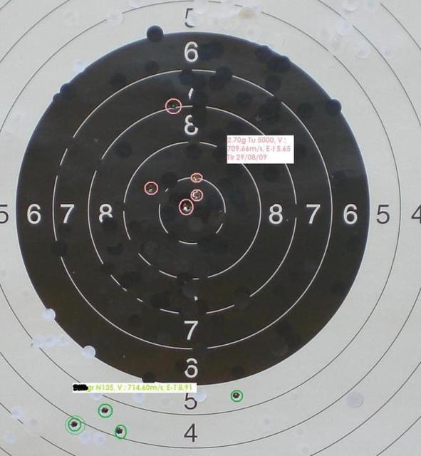

    Gents, when I was posting the picture of my target, I wondered why this was not so bad despite "the vibration".
    So, I applied some advised read in this post, then I practised today some dry firing (thanks MK VII). I took care of the position of my wrist on the butt, (thanks Bruce in Oz)
    I noticed that the "vibration" is noticeable when the firing pin comes forward and create a 'clack' (dry firing), but it is not due to the rifle itself, but to me.
    So I'm faulty. Thank you for your advises.
