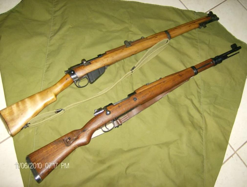

    No 1 Mk 3 question
    The SMLE in the photo was acquired at a gun show some time ago. It's marked "G.R." with a manufacture date of 1911. It's also marked "FTR 1953". Somewhat curiously, it has a close-to-mint bore, and is in overall excellent condition. I didn't notice until someone mentioned it, but it has been fitted with a No 4 buttstock and cocking piece.
    I've been told that this batch of FTR's was for commercial/export purposes. Was this indeed the case?

    BSA carried out a large No1 FTR programme in 1953.
    The rifles were commonly rebuilt using new barrels, beech furniture, No4 butts/ striker/ cocking piece.
    Usually very nice rifles.....

    No4 butts and many other interchangeable parts or parts that could very quickly/simply be interchangeable, such as those listed by TBox plus BA threaded screws, butt plates - you can see the sort of stuff we mean - were all acceptable in the UKicon Military and sanctioned in our Engineering regulations, known as the Bible or just plain old EMER's
