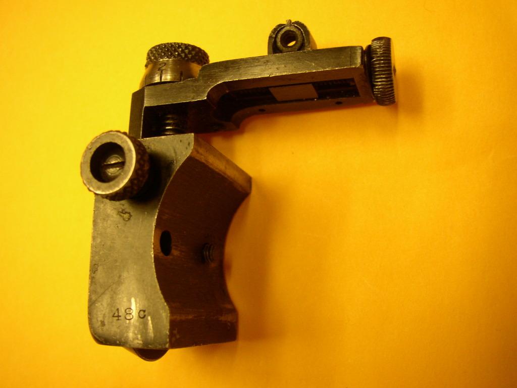

    I am looking for comments/opinions from collectors and even hopefully our well known experts here on this forum to settle a matter.
    I recently sold a early first variation Lyman 48 sight on ebay. I believe I described the sight to the best of my abilities and provided what I believe are suitable pictures to show the details. The buyer expected a later model sight with later features and states that my sight was "not as described" I will provide the auction listing as well as correspondence (with names omitted).
    http://cgi.ebay.com/ws/eBayISAPI.dll...#ht_500wt_1413
    Dear Seller
    I recently purchased this sight on your auction and just unpacked it as I have been out of town. I have several problems with the sight.
    Although the receiver mount appears to fit a springfield receiver, it cannot be mounted without cutting a notch in the stock. Secondly, the elevation adjustment cannot travel the full range of 150 minutes.
    Thirdly I believe that the windage bridge looks like it came from another sight made to mount on the right side of the receiver. All Lyman 48 sights have the windage scale on the rear of the bridge toward the shooter. This sight has the scale on the muzzle side of the bridge. My conclusion is that the base mount and the windage bridge came from two different sights. I consulted a colleague of mine who has a Lyman 48 Springfield sight and his assessment of this sight is the same as mine. As such I want to return this sight to you for a refund refund as it is certainly not a 48S 0r 48C sight.
    My reply:
    I clearly labeled the sight as an early version made from 1911-1919 with unnotched base. ALL Lyman 1903 sights made BEFORE 1947 were not notched and required notching of the stock to fit. Please research original NRA Sporters and any 48 equipped rifle on Gunbroker or Google and you will see that they always required notching of the stock, even on factory built sporters. The THIRD variation of the 48 sight with the notched base to fit around the stock wood came out around 1947.
    Please advise further about the slide not reaching the full adjustment range. Have you tried adjusting the pointer downward??
    Third, you state that "All Lyman 48 sights have the windage scale on the rear of the bridge toward the shooter." The sight I sold you DOES have the scale on the rear of the bridge, but later sights were made with the scale on the front because you could see it better. You imply that the windage bridge came from another rifle. The slide/bridge has an assembly code stamped on the inside that matches the code on the inside of the base. These parts were fitted together at the factory and numbered to match. Pictures of which are clearly shown in the auction and you can pull back on the knurled knob on the base and remove the slide yourself to inspect the matching numbers. Again, this is an early sight and correct for this time period.
    You state that your colleague has a 48 sight that is different. Is his a early first variation or a later model?
    If possible, would you members on this forum please provide third party pictures of early Lyman sights and the required stock cutouts?

    Is it possible that this is a Mauser 48 sight? I have now noticed the difference in the horizontal part of the windage slide, apparently the 1903 version has on offset to reach over the receiver hump. Do you concur Mr Petrov?
    Was this the difference making it not for a 1903 or are their other issues?
    I bought the sight some time ago and it was sold to me as a 1903 sight and since Lyman did not mark application codes back then assumed it was correct and it fit fine on my rifle.

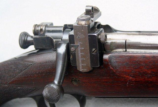

    I think it may well be for a Mauser. As you note, the windage arm does not have the "dog leg" to clear the rear "hump" on the receiver.
    I have never seen a 1903 Lyman 48 that does not have the "dog leg".
    I recently glommed this one on fleabay...
    Lyman Model 48 series target sight for M1903 series rifles | eBay
    I have a short slide Lyman 48 on a Remington 1903 ...
    I also have a currently unemployed Lyman 48C, which is one of the older type requiring that the stock be "notched".
    As you can see they all have the "dog leg"

    I apologize that I just don't have time to do proper research. The crossbar is flat (like a Mauser) but the base is not cut for the clip slot which is found on both the Mauser and 03. I hope this helps.

    Thank you for the comments. Since the later SME sights fit Mausers and 1903's I never considered that they would make two seperate sights in the early days. Other than the doglegged windage arm I would have never seen a difference.
    I have contacted the buyer with an apology and offer for full refund including shipping costs. I think he would have been more suited looking for a third variation or a early 57SME to suit his needs anyways.
    Thanks again for clearing this up.

    I've been thinking about your sight and wounder if you have looked at what 48 fit the Winchester 54?

    I think the Winchester 54 and 70 Lyman 48's are made to fit on the left hand side of the receiver, aren't they?

    I believe Micheal is correct, it's a 48W. Those were not marked early on.

    Just to close this out, I gave the buyer a full refund plus return shipping. I turned the aperture around so the sight will work from a left side mounting like it should. The sight was sold to me as for a 1903 but now thanks to your help I know it is a 48W.
