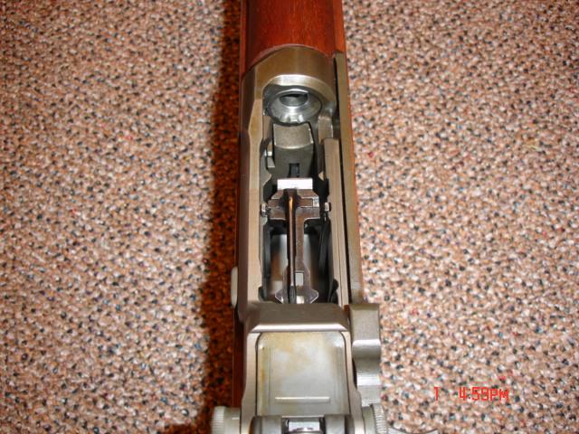

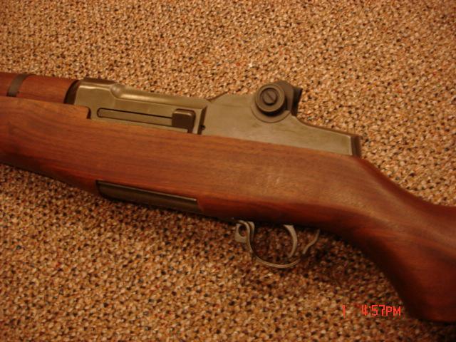

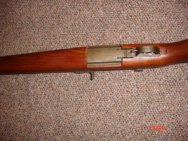

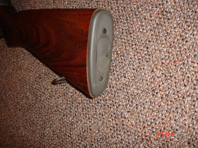

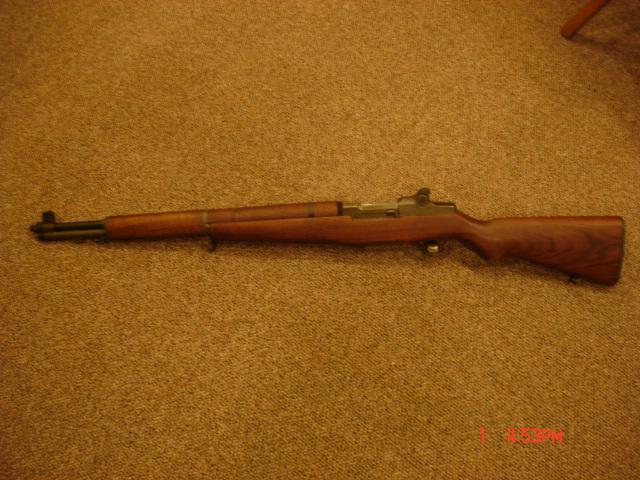

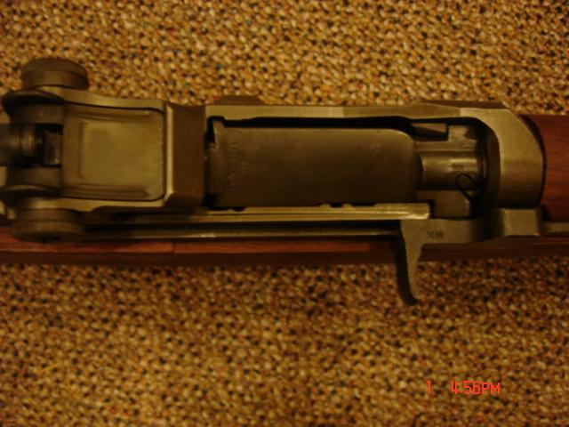

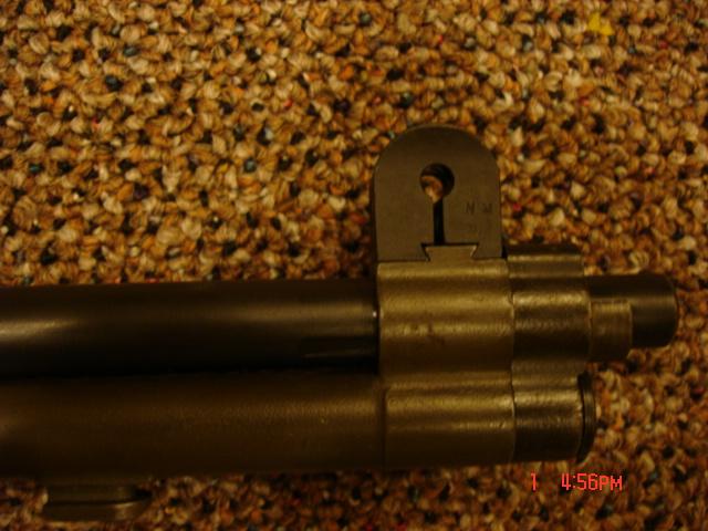

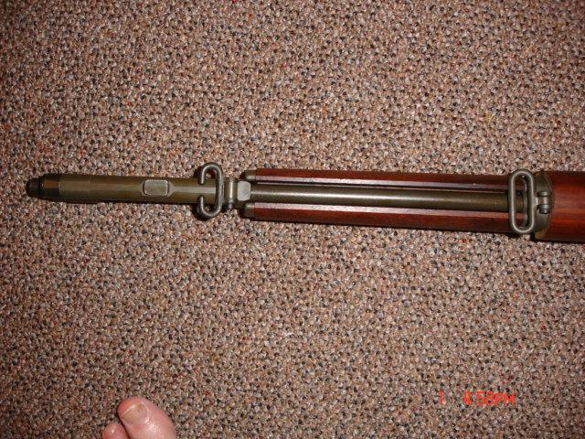

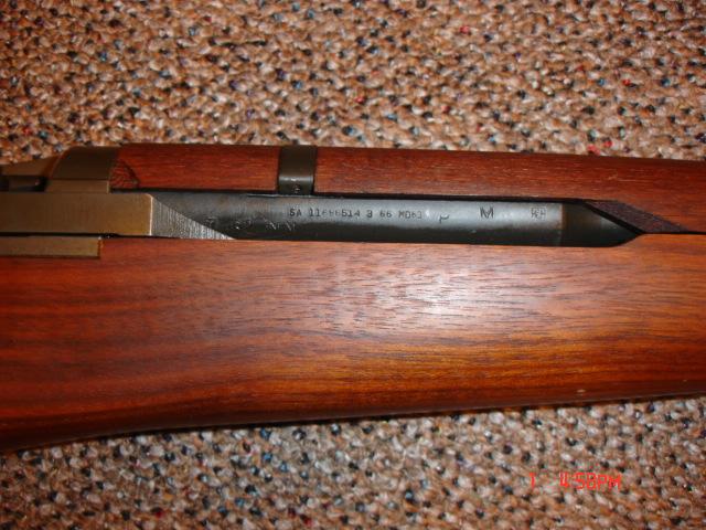

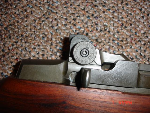

    Just picked up a nice Springfield wih NM sights & op rod. Stock is glass bedded. Barrel is 3-66 manufacture . Appears to be a Navy 7.62 Match but since I have never seen one before posting photos for comments.
    Looking for your comments
    thanks
    Leggett

    It sure looks like it was done for NM, there's a few here that will know for sure...

    It's nice enough to have been a SecNav Trophy Rifle -- let's ask Jim Adell to check his serial list.

    Would a SecNav Trophy Rifle have a metal 308 cartridge spacer or did they only use the white plastic spacers?

    Remember the white ones sometimes broke. Some people have no faith in them so it could have been changed.

    I think in Service rifles used the white, plastic spacers. This is a very well done match rifle, but not likely SecNavy rifle.

    White plastic was first and standard I think. The metal was an afterthought much later...

    I sent all the info to Jim Adell in a seperate e-mail after reading a GCAicon member's suggestion to another post. This rifle came from an estate in South Dakota that a local gunsmith in Oklahoma bought in total. Saw it at the shop when I was picking up a H&R M12 I had shipped there. No papers & he thought it was a std garand someone had added NM parts to but with the correct barrel and build details as described by Joe Poyer's "The M1icon Garand 1936-1957" I could not leave it in his shop, it had to come home with me. Would be great if Jim could verfy it is a Navy NM.
    Thanks for all the comments so far. Looking forward to see what other info may surface.
    By the way the receiver is a Springfield sn 4,374,XXX
    Leggett
