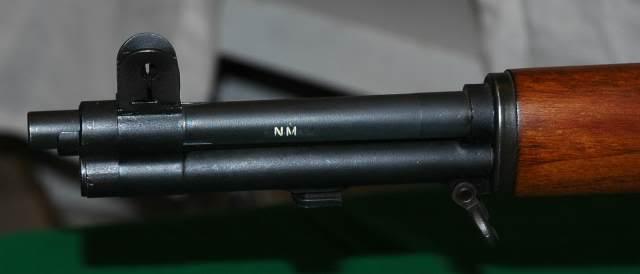

    The article you quoted failed to mention that ALL National Match rifles will have the barrel marked NM between the rings of the gas cylinder. If the barrel is not marked in that manner it is, without a doubt, NOT a NM rifle.
    Here is another article for you to read. If you rtead it closely you will see it mentions the NM marking on the barrel. The National Match M1icon
    This is the NM marking on the barrel:
