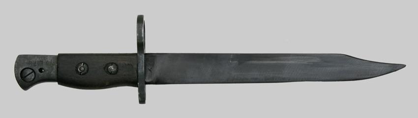

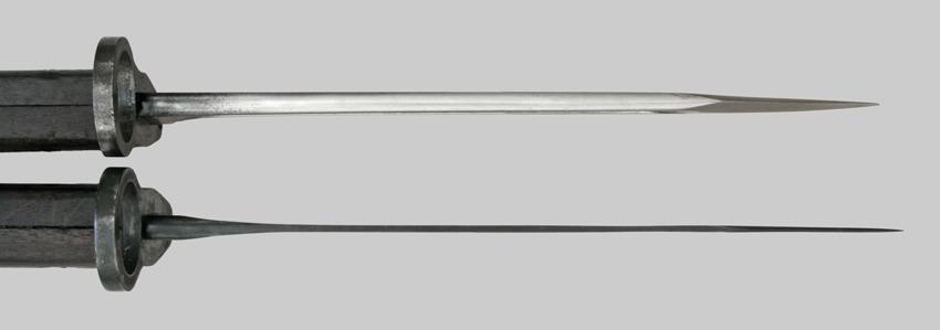

    I have a No. 5 Mk. I bayonet that has been modified by thinning the blade to the depth of the fuller, then bluing the blade. I have heard this modification attributed to the Malaya Government, but have not been able to find any information substantiating the Malayan connection. The bayonet and its scabbard are both Wartime Wilkinson production. I was hoping someone here might be able to shed some light on this modification.

    Our machine shops made/converted hundreds of these into letter openers for visiting dignitaries right down to every man and his dog who wanted one! It was never a government thing or sanctioned by anyone............. Just a little scam worked by the fitter/turners in the machine shops and Armourers to earn a few Malay dollars and while away the time and as a means of using up old bent or otherwise unserviceable bayonets - of which there were hundreds! I had one for many years that was beautifully engraved by one of the Instrument technicians, Bob Sterling, who could only hold his hands steady enough to operate the panto-engraver when he was slightly drunk. These will have been done all over the Far East. Then, with the extra money we had earned on the back of this scam, us young lads could use it to buy extra wool for our knitting and sewing classes or just add these ill-gotten gains to the church collection plate every Sunday................. Just joking!
    That's the story of the slimmed down No5 bayonets. I was told at the time that the L1A1 bayonets were a much tougher material and harder internally too and didn't take to the surface grinder too well. That's why there weren't many done. There was no need because we had zillions of No5 bayonets left over from the No5 rifles and Sterlings/L2A3's when we got AR15's
    If the muzzle rings were bent back or forwards, you had to be VERY careful not to do anything apart from heat the bent part to cherry red and bend it back to shape otherwise it would just break off. We could weld one side but not both sides if it broke off. You could make a new ring of spring steel wire but the unit cost was such that it wasn't economic - although '.......the needs of the service' as I remember the phrase, always out weighed anything else, including EMER's!
    Sorry if I have rambled on a bit. If it's all too much, just ignore the bits that are mind numbing!
