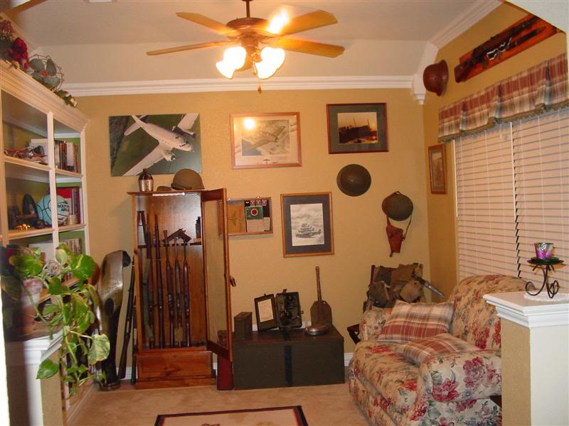

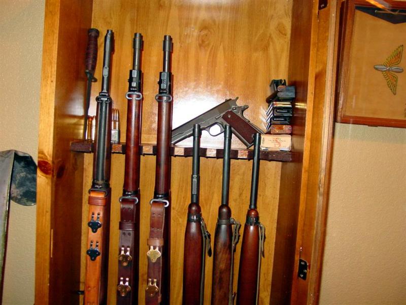

    I did something similar several years ago using a small antique gun cabinet I bought from an estate auction.
    I keep all my guns in a large safe, but wanted to display a few of them at a time -
    (Mostly so I could see them!)
    I rotate different rifles at different times, as seen from some of the photos I just found on my hard drive.
    I'd be worried about the chain though - no matter how careful, it will leave marks if used much.
    I bolted a heavy duty, plastic covered cable lock to the wall studs and then mounted the gun cabinet to the wall, leaving only enough cable to reach through and lock. (Just an idea)

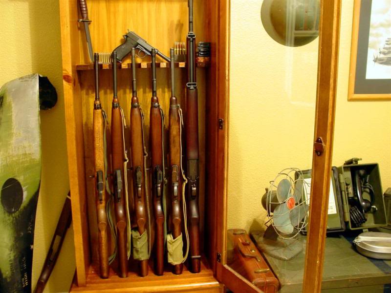

    Mark,
    I installed a small LED strip in the top of my old cabinet and it worked great!
    You can see it in this photo with the door open. With the door closed it covers up the light casing and wire. The LED's don't put out any heat. There's a small switch on the outside top so the light can be turned off and on, and the power cord is routed behind the cabinet to an outlet.
