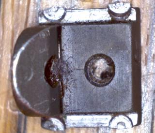

    Attachment 36316Attachment 36316
    I usually just bump the four corners and then dress them up to a perfect fit with the ramp slots.
    not sure how I got 2 pictures oh well

    Even with a 4 oz hammer I hit it too hard.
    I have it dressed now and it fits.
    Thanks again,
    Szumi
