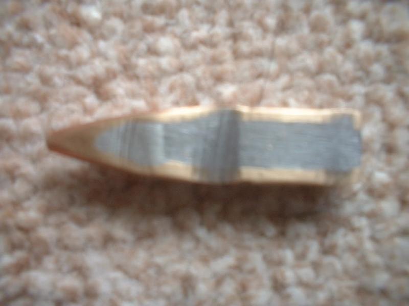

    Quote Originally Posted by David TS View Post
    Unfortunately not, it is a boat tail. I don't reload, and I don't know of anyone in the UKicon (Kynamco, HPS, PPU) that loads commercial rounds with a flat base
    The Kynamco I have does have the flat base bullets
    (excuse the quality of the sectioning I only had a rusty screwdriver and an angle-grinder)
    https://www.milsurps.com/images/impo...SCF00292-1.jpg
    https://www.milsurps.com/images/impo...SCF00261-1.jpg
    Now that's really interesting, thank you.
    I didn't realise Sierra actually did a flat base SMK! They list them as a BT. Guess I'd better pull one of mine and see what I have
