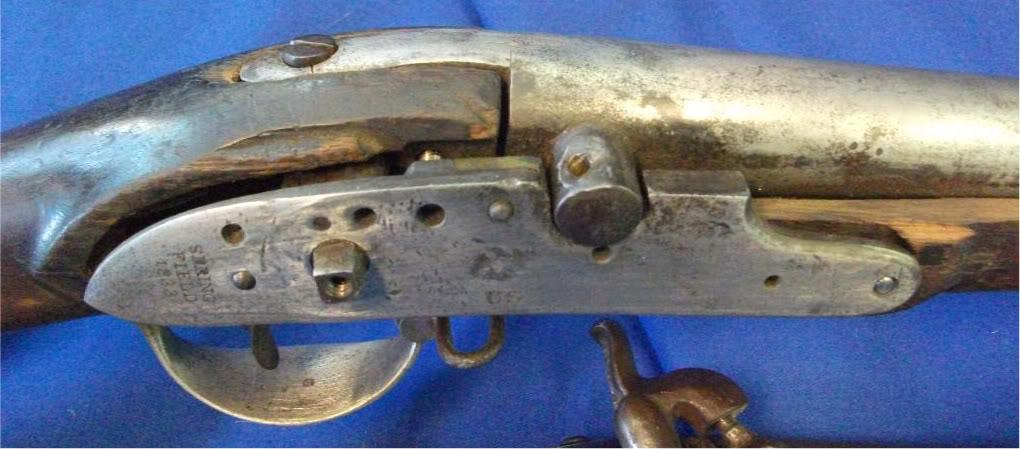

    I bought a formerly Belgian conversioned and then shotguned P&EW Blake 1829 musket from a friend who has too many fix it projects to finish up myself and use for living history. I am putting it back into flintlock order, but will hang on to the conversion parts (hammer and pan filler) as part of the gun's history and service life.
    He had already expertly relengthened the barrel and plugged and welded the Belgian conversion, but had not done much else.
    I started by taking all the parts off the shortened stock, ordering the missing bits, and began the "dig" for info.
    As those familiar with the story know, the Eli Whitney attempted to make the first interchangable guns as part of his long running contracts. His nephews, Phineas and E. W. Blake took over after his death and continued to get contracts for US muskets. These guns were never interchangeable, as my cleaning showed.
    Every original part - stock, buttplate, trigger guard/bow, sideplate, trigger, barrel, and breech plug, were marked in a hidden place with three lines, representing the Roman number III, as assembly numbers - to match up the non-interchangeable (but close) parts. Several sub-contractor or inspector marks came up out of the grime and rust with gentle cleaning. S on the buttplate and sideplate, JS under the trigger guard, CB on the front of the guard, C on the barrel and in the tang channel of the stock, H on the barrel and breech plug. Two sets of index marks for the barrel/plug - one from the original flint, the second likely from the conversion to percussion (checking the abomination of the Belgian conversion?)
    Now its to make up a matched forearm - will be a chore to match the lovely patina of the old stock that is quite sound except around the flint burn area. Usual initials on the stock of a soldier long ago.
    Pictures later when I get this more done, but I am excited to find so many of the parts are original to its making 180 years ago.
