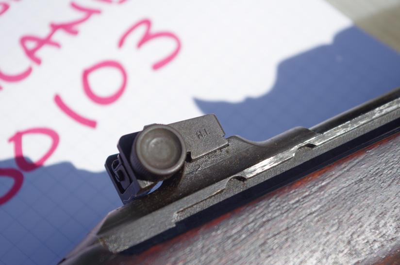

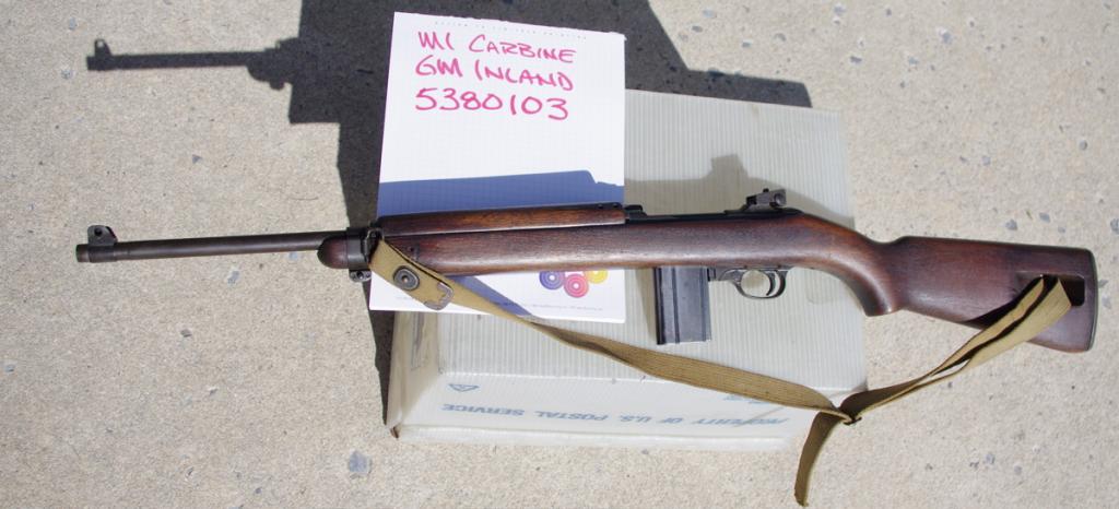

    Today, in the latest episode of "What the Heck Did I Buy?" we have an M1icon Carbine I purchased at auction Saturday.
    I'm a novice at military arms of all kinds, but here (I think) are the essentials ...
    M1 Carbine
    General Motors Inland Division
    Serial 5380103
    Rear sight marked "H.I."
    Front sight marked "N"
    Stock has no arsenal rebuild stamps
    Round bolt
    Side-by-side mag release and safety
    You'll find a few images below. Any thoughts?

    I'm not sure if the round bolts were WWII era or not. I guess I should go get the book I have. I guess the rear sight might be a question too, but I think some were saying it might have been used as early as WWII. Although I think it's a more later style adjustable sight. Isn't that a "type III" guys?

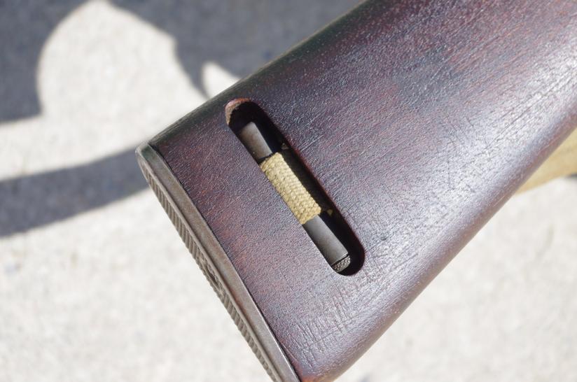

    Is it a high wood stock? Can't tell by the pictures.

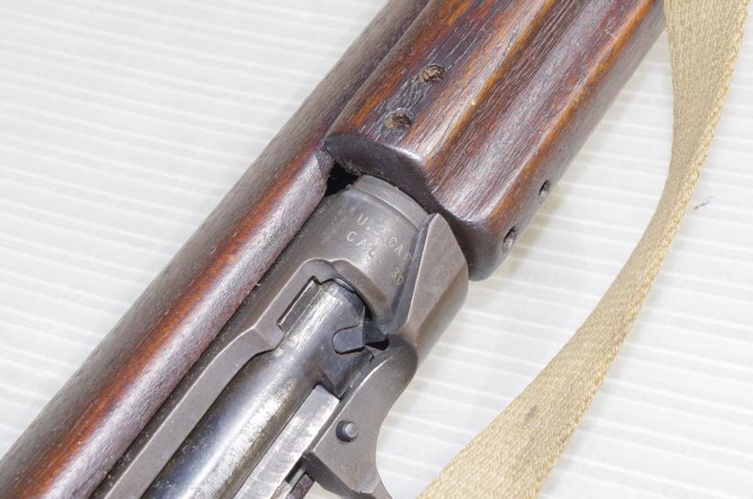

    The type 3 round bolt started about Feb. 1944. It was a standard bolt for the M1icon carbine and was the only bolt being made and used by the end of carbine production in April 1944 for almost all the makers except Inland and Winchester who used it till the end of their production in the late summer of 1945. Standard Products was the only other maker that did not use the type 3 bolt before ending their contracts to make carbines.
    The rear sight is a type 2 milled sight made for Inland. The carbine appears to be in original configuration for the serial number but that would also depend on what is inside.

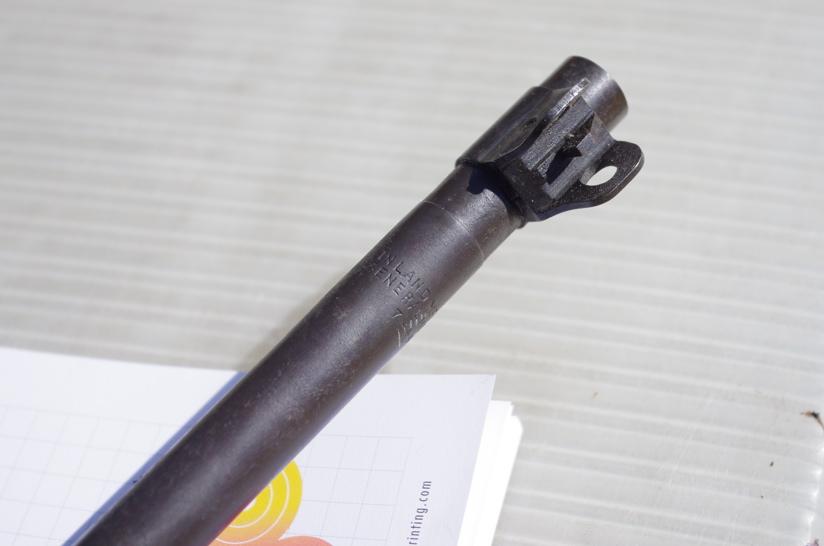

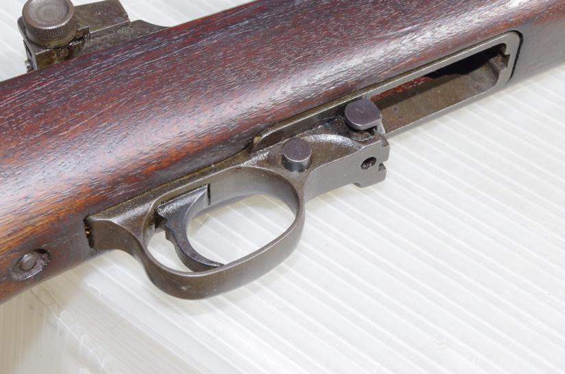

    Is that barrel date 7-44? I've got an Inland with s/n 5,413,XXX that has an 8-44 barrel. Everything looks right to me including the blued round bolt, "M" mag release, push safety, Type 5 slide, "N" front sight, Type II rear sight, Type II barrel band, and 4 rivet handguard. In my opinion the oiler is upside down - not sure if the sling should be tan or OD, but that's not a big deal. - Bob

    Looks identical to a 5.4 million original I have. Barrel date on mine is 8-44. I believe it is original.

    My pet peeve is people trying to recreate a WWII appearance by replacing a type III barrel band with a type I or type II. That almost always leaves a type III shadow on the fore end of the stock and barrel. To me, that's an indication of whether or not it's been fooled with. I see no indication of that on yours. Good find!

    The cutout in the lower portion of the stock is approximately 9.75 inches long. I believe that makes it a "low wood" stock.
    Yes, the barrel date is 7-44.
    Oh, and by the way, I'm responsible for the oiler being upside down =(
