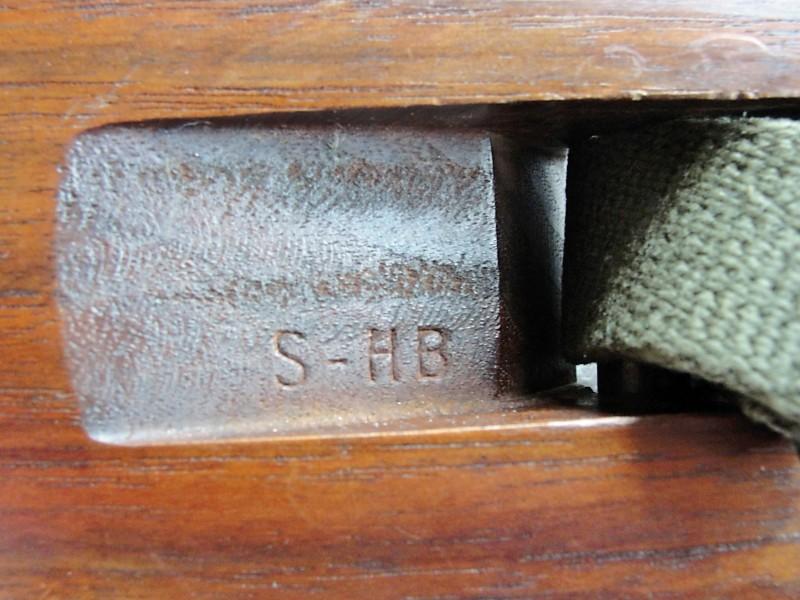

    What would it mean if my stock didn't have arsenal rebuild stamps on it?
    I can't find any markings anywhere on my stock except for this:
    There's no P or initials or anything. And obviously this carbine is a rebuild.
    Is it a fake? It's a nice stock, but it does seem a little more glossy than most I see. Or maybe that means someone sanded it finer. I don't know.
    I'm sure most of you have seen it before and maybe I'm wearing out my welcome, but I figured I'd ask anyways. It has me scratching my head.

    That marking may be be for a replacement stock. If they put a new stock on it during the rebuild they may not have marked it. Also, the stock may have been damaged and replaced after the rebuild.

    S-HB is a stock made for Standard Products by Hillerich & Bradsby Co. regular production. It appears to be a type 2 cut down to a type 3. Not all rebuilds were done at the armories. It well could have been done at a lower level of maintenance and as such would not be marked.

    Well that is good news. So at least it looks like it's USGI. I wasn't sure.
    What does "cut down" mean?

    Type one ( I cut oiler hole ) and type 2 ( oval oiler hole ) were high wood stocks. The line of the stock forward of the op rod in your pic , continued rearward over the op rod. The wood in this area is very thin due to the cut needed to clear the op rod. Many broke out in service , so they went to the type 3 stock like what you have in your pic . Most type 1 & 2 stocks were modified by " cutting down " that thin rail into the configuration you have when they went through rebuild or in the field if they were split out.

    So what type of oiler hole does a type III have? Because if I'm reading this correctly, you're saying I have a type II that's cut down to the low wood position, and you can tell this by the oiler hole. But is the oiler hole different on a type III that would distinguish this one?
