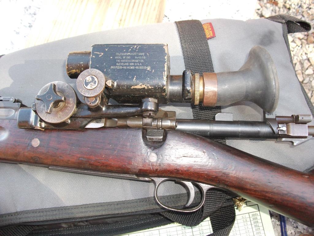

    Just as a closing thought, the edge to edge dimension isn't a great indicator of whether the dovetail itself is correctly dimensioned. Any radiusing of the edge will change the size whilst not affecting the fit of the assembly.
    And what's a thread without a photo?
    Don't think I've one with the scope off, yet.

    Quote Originally Posted by Salt Flat View Post
    Awesome picture. That rifle looks totally untouched since 1918!
    I wish! The scope and mount are original. But not to that rifle. It's too old. And the stock is a little too new for the rifle. (Two reinforcement cross screws.) It shoots well, though, with ammo it likes. Horribly with ammo it doesn't!
