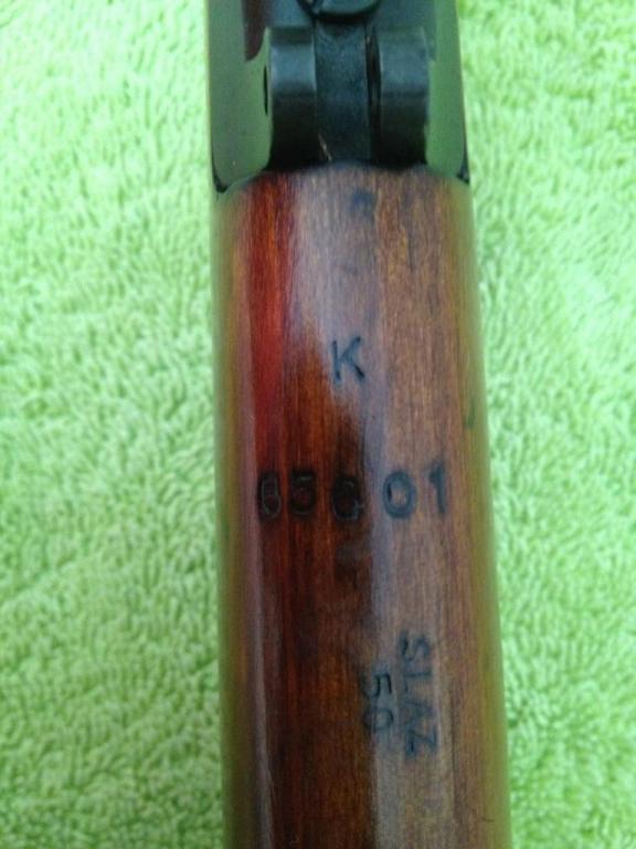

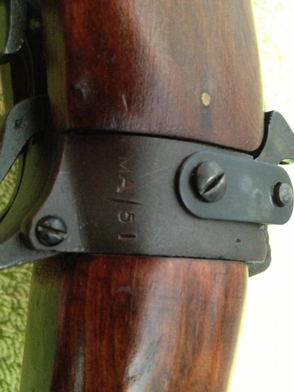

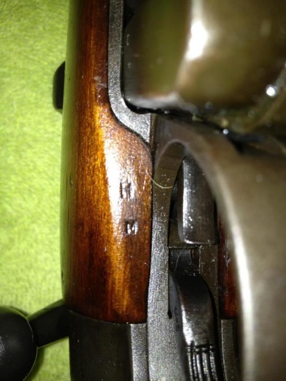

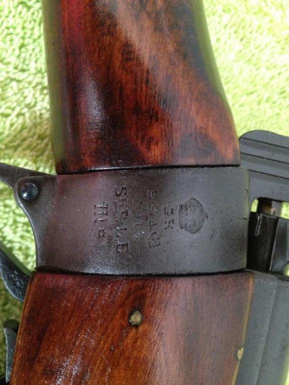

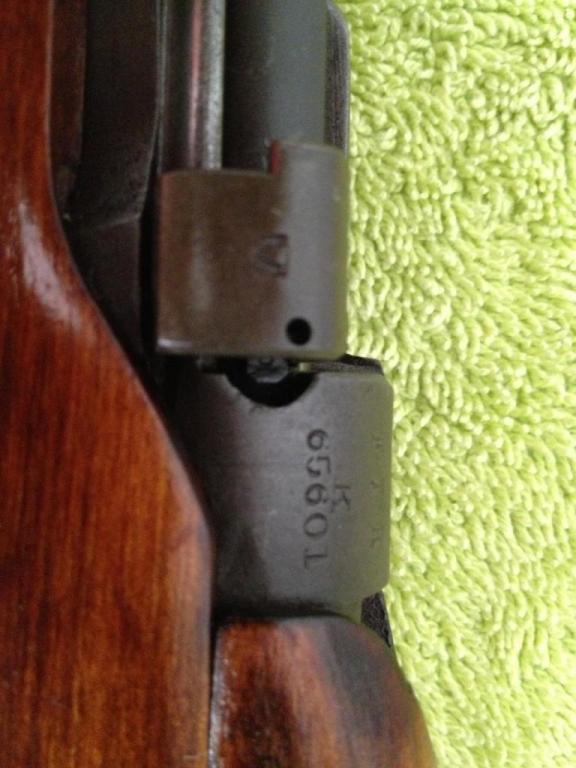

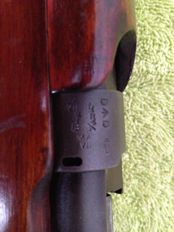

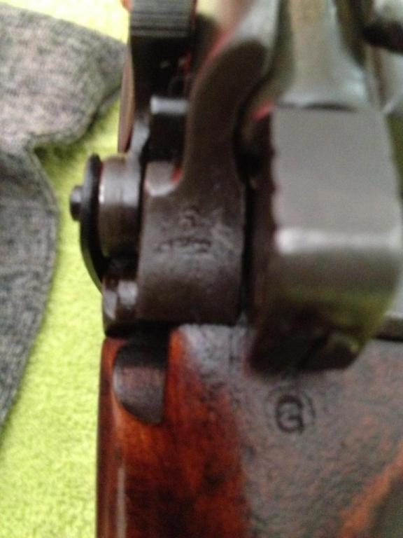

    G'day,
    I am new to the forum and I have recently got the milsurp bug. One of my purchases is a 1919 BSA Lee Enfield and I was wondering if anyone with a similar rifle could decode the markings? I am in Australiaicon and apparently the rifle was government refurbished in the 40s (?) as was sold unfired after that to the previous owner a few decades ago. It apparently has had only had one box of ammo through it. This is all 'hear say' so I am keen to get as much of its genuine history as I can through its markings. The stock has a semi-gloss look to it so I am presuming this was done after the government refurbishment? Or did they ever give them a semi-gloss finish? It is in great condition, the barrel looks new and all numbers match.
    Thanks in advance.

    The MA/51 indicates the rifle was refurbished in 1951 at Lithgow, Australia.
    The D^D on the receiver ring indicated Australianicon Department of Defense ownership.
    The SLAZ 50 on the fore stock indicates the wood was produced by Slazenger in 1950
    The gloss finish as already indicated is not original military finish

    I'll only add that the '1919' appears to read '1918' to me.

    Welcome dessy, the year is definately 1918.

    As stated the finish is not original, the rifle looks like a very nice example though.
