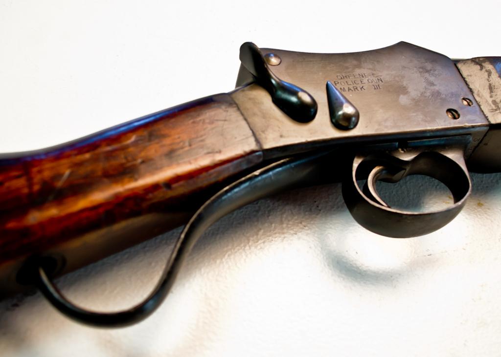

    Can any decipher the markings on Greener shotguns?
    Looks like some Greener shotguns just came onto the market.
    I understand this model saw use in the Britishicon overseas colonies, but might anyone be able to decipher the stampings on the example photo for a history on location? (I assume the entire batch Royal Tiger Imports are selling off, are from the same source country?

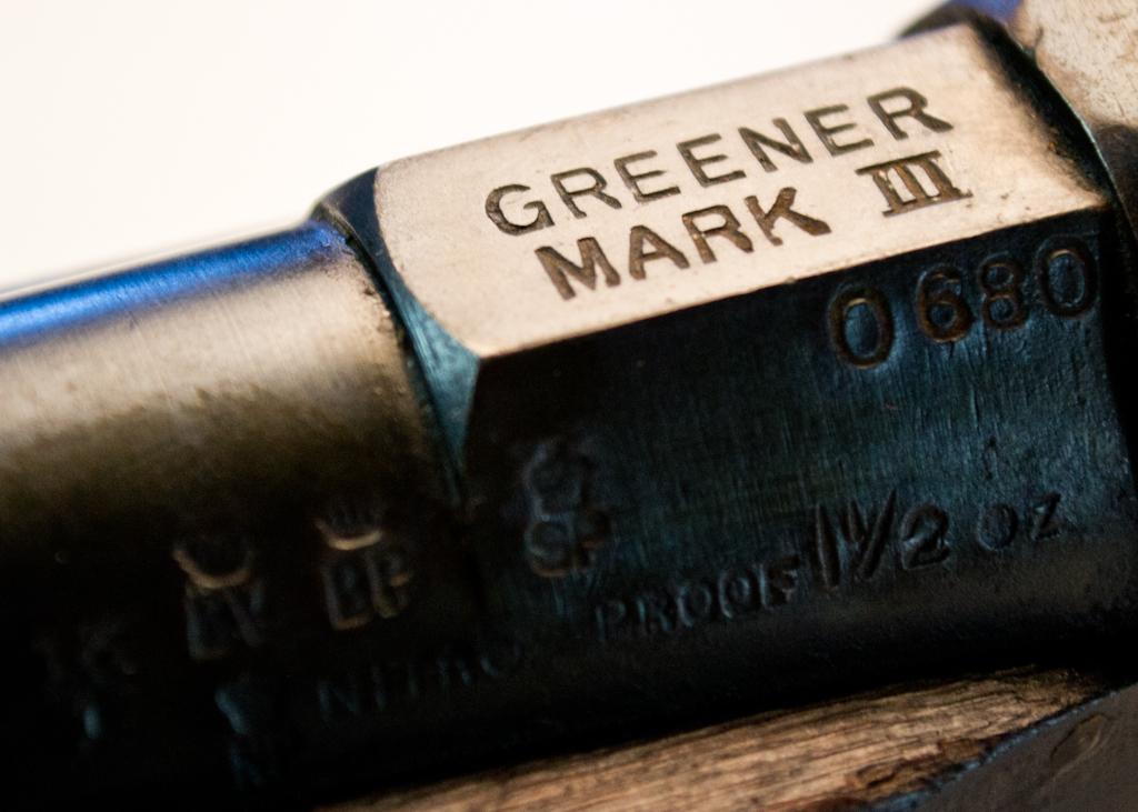

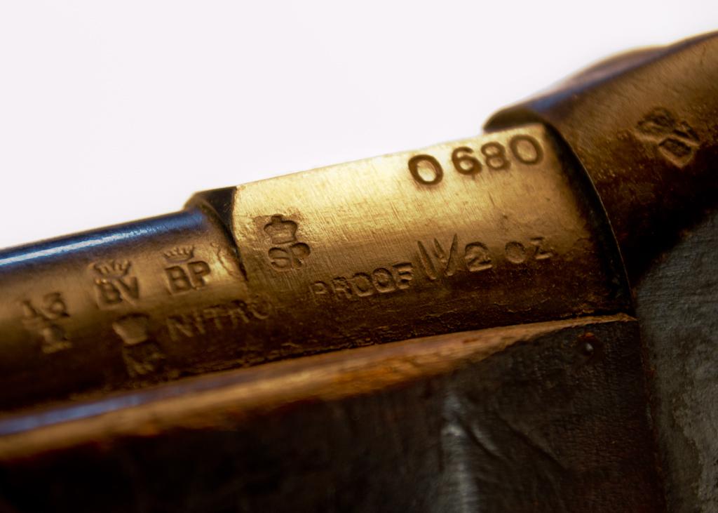

    Quote Originally Posted by regress View Post
    13 over (should be a C) = the (nominal) caliber
    - in this case, considerably more complex that usual - see the explanation above!
    crown over BV = view mark applied after final proof
    crown over BP = final black powder proof
    crown over SP = voluntary special proof with extra heavy load
    All the above "crown over..." are Birmingham proof marks
    The standard load is given here as 1.5 ounces = 41.524 grams or 656 grains ***
    NP= nitro proof
    *** of shot (load) - not powder (charge)

    I would have thought that the 1.5 referred to the shot, not the powder.
    Sep 2008
    06-25-2023 @ 06:36 AM
    5,032
    06-11-2025
    08:54 PM
    Quote Originally Posted by muffett.2008 View Post
    Yes it does. I wrote the load, not the charge.
    A specified charge would also require a powder to be specified. And even for the most extreme "hot load" freaks - who are, of course, using the word inaccurately - a 656 grain charge would seem a trifle excessive. The confusion arises from indiscriminate use of the verb "to load" for both the charging of the case and the loading of the projectile (or projectiles, when shot is used).

    Thanks for the feedback everyone.
    So it would appear we have no means to determine in which colony this particular shotgun was likely stationed?
    Sep 2008
    5,032
    06-11-2025
    08:54 PM
    For that, we are looking in the wrong place! If there are any unit/ownership marks they are most likely to be on the butt. Stamps were commonly used on the wood - it is much easier to mark than the metal - but the marks get smoothed out over the decades. A close investigation of the right side of the butt or under the wrist might reveal something.
