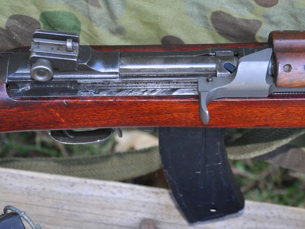

    Pictures of my baby, "Pork Chop"
    With Utica M4 bayonet attached:
    Round bolt from Northridge and Type V slide from WW321q
    Nice cross cannon cartouched Inland birchwood pot-belly stock and 4 rivit handguard from Bill Hollinger:
    "AI" Type III barrel band and Utica M4 bayonet

    Wow! ya got a pretty good collection there. Great looking rifle there too. Thanks for the pics.

    I believe that's the first time a pot bellied stocked carbine has really looked attractive to me. If it runs as well as it looks, you ought to be able to take "Pork Chop" Hill all by yourself!
    Downright swoopy lookin'.

    I agree about the stock, it is beautiful (THANKS BILL!) So far, she runs great. Several hundred rounds of various makers ammo (RP 110 JSP and FMJ, Prvi 110 JSP) from 30s and 15s with ZERO malfunctions. Dead-nuts on at 100 using a 6 o'clock hold, pop cans bite the dust! I'm going to try a 30 round magazine of the 115 Bear Creek moly bullets over 11 grain Alliant 2400 tonight, just to check function with those
